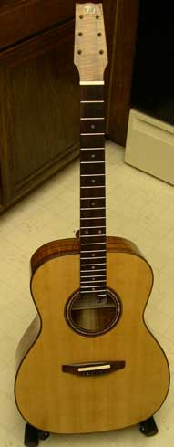

I actually *LIKE* my tops to have some color and striping, I choose them based on that (along with other things).
If it's got good tap tone I would use it, I built this one out a piece of Spruce top I found at a wood store (read not a normal place to find tops) in the bay area and it ROCKS!!
In fact the top looks better because of the striping IMHO
Use it, take your time doing the rosette and you'll have a great guitar.

I like it too.
Nobody paints sunburst acoustic guitars anymore. I always thought they were neat.
