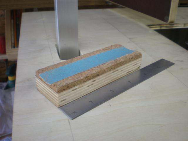

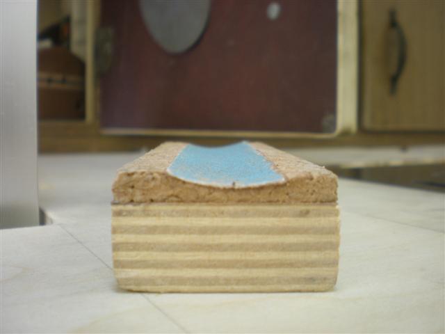

I've got a little block of wood that I sanded a concave radius into for shaping the reinforcement strip. I put some 100 grit on it and do a rough shape with the block plane than go to the sanding block. I'll post a picture when I get down in the shop later tonight.

PostPosted: Mon Jul 09, 2007 7:36 am
[quote=The Heshter]Cool Rod a sanding jig now that is a GOOD idea so be sure to post a pic later when you can OK? [/quote]
You make it sound elaborate using the word jig.
Just a sanding block really
Here you go, easy as pie (mmmmmmmm, pie)
You know what would be really cool with this "jig " is if that curve were recessed into the block by 3/32" with some vertical walls to run along the edge of the strip. If it were the same basic dimension as the width of the strip you'd have a perfectly arched strip every time.
Another idea for the scrap book (gotta make this next time).
