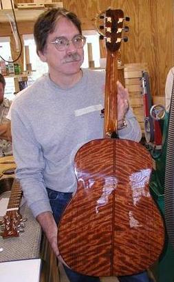

This is a test to see if I can post a shot of a new guitar built just before Christmas. My bro gave me the wood for a present (you see how nice it is to be related not only to a great guy, but a luthier to boot!) The top is a piece of Bearclaw Sitka snagged at a GAL convention back in '01.    Hope this works! And if it does, Lance you could use one of these pix for a replacement on the bio page? Just a thought. I'm at least clean-shaven.Steve Kinnaird38360.6174189815

Steve...Beautiful! Very Zooty!
Welcome back from the "Fountain of Youth". No wonder those lady parishioners pinched that smooth-shaven mug!

Bruce--while you were posting, I edited my message and put the larger ones in. I think the Bubinga is just too pretty not to get a better look. Try again and see what'cha think....

Steve what a beauty that is. Love that curly bubinga and bearclaw top. Hey Lance change the bio pic to this young man.

You Kinnaird brothers really CAN build guitars!
PostPosted: Sat Jan 08, 2005 7:04 am
Bob--or Lance--that'll work if you can edit out the guy hovering over my right shoulder. He looks like he might be my conscience nagging me over something.

Steve...That is really beautiful! I love bubinga. I have built three so far. Thanks to BOBC I have about five sets of some real beautiful stuff. Anyway, you are very lucky to have a Brother who loves you enough to give up that Set!!

Many thanks fellas for your kind words. Paul- I was scared of this stuff too. I'd heard plenty of horror stories about bending Bubinga, and here this stuff was crazy curly. I was sweating bullets. However, when the iron got good and hot, this wood bent like plastic. Lumpy plastic, but plastic nonetheless. What impressed me the most was the sound... it sounds like rosewood, only more so. This might be the best sounding guitar I've built yet, and part of that is emanating from that bubinga. Now, LANCE---HOW did you do that w/ the picture? You're my hero. Can I send you my driver's license photo? I bet you could clean that thing up and make me look respectable.

Great looking guitar Syeve. I'd really like to see some more of your work. I think I've seen a couple and have been impressed each time. I'm hoping to order some of Bob Bubinga soon.

REALLY Pretty job. I do like that bubinga, think I'll build one too.
Back before I knew Bob C, I bought a plank of bubinga from Gilmer and resawed it into a few sets. That is one of them. Now my allegances have switched and Bob gets all my spare money.
But, now that I know where everyone went, let me congratulate you on a great looking instrument, and if you claim that it is you best sounding guitar to date, then it must be quite a guitar.

That is really beautiful! Very impressive. I love the top and purfling also!
