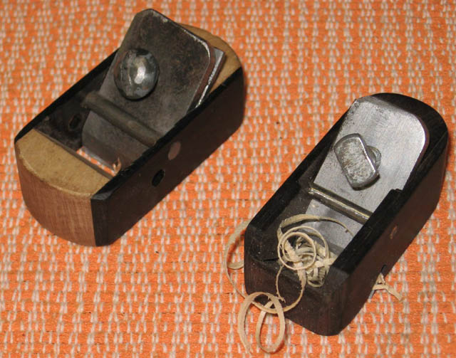

I use a long chisel and thee 2 small homemade planes
The blades in these are 3/4" wide.

I have not seen Mark on the OLF for some time, but they are excellent little planes.
I also should elaborate a little on my earlier answer, I use this little handmade brass plane 1/2", and I use a chisel and sandpaper to finish.

I use the Lee Valley rosewood planes, one of which is chopped to look just like one of Alains above ... the other not quite as short, but modded as well
