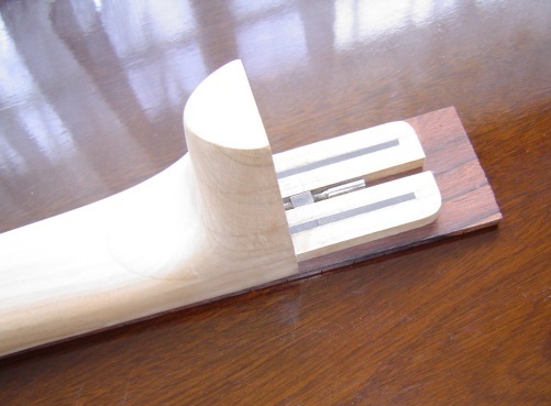

There's a major misunderstanding going on here about what I do with the graphite in the fingerboards and necks...
It's not 1/8" x 1/8", that would be kind of dumb.
It's 1/8" x 1/2" tall and I put two in the full length of the fingerboard. The height is reduced over the body, but in the neck it's full height. I dado 1/8" deep slots into the underside of the fingerboard and glue the graphite in
As far as the "system" goes, it's not quite accurate to dismiss the contribution of an ultra stiff fingerboard system to the overall stiffness of the neck.   I consider this fingerboard system to be the primary structural element of the whole neck, and the great thing about it is the stability that it imparts to the line of the fret tops.   There is no issue of a hump or dip at the neck joint, and the fingerboard stays incredibly predictable...and that means playability is predictable.
The Antarctic guitar has not needed any neck work since the day it first left my shop about six years ago. That guitar has been through some of the worst climactic changes I can imagine, and it still plays great. There is a double acting truss rod in the neck, and it's there to allow adjusting the relief in the fingerboard, not to compensate for any weakness in the neck.
This concept of a structural fingerboard is not the only way to build a good neck, but it sure works for me with these instruments.   As we move over more and more to CNC manufacturing here, I'll be extending this way of building necks into more of the instruments we build. It will also be perfect for the ceramic fret project where fret top stability becomes paramount as there's no possibility of doing any fret milling.   I showed a guitar with ceramic frets at the SIMSCAL meeting, and it, too, had one of the "structural fingerboards".

I'm not just moving the graphite up. Normally I use 3/8" tall by 1/8" wide strips.   Dadoing up into the fingerboard allows me to use 1/2" tall stock...33% taller and probably close to 50% stiffer than I could otherwise use.
For a well-respected magazine writer's take on the results we achieve, check out Art Thopmpson's review of the Koa/Russian jumbo that we just got in the latest Guitar Player Magazine...the August issue. I'll just say that seeing that triggered a major grin festival around here...
While the whole bit about the neutral axis is absolutely correct, it's not all there is to designing and making necks.   I'm advocating for maximum stability in the fret tops...and that's not exactly the same as saying maximum stiffness for the neck.   Also, putting the graphite at the surface...which is what my 1978 patent is all about...severely limits neck shape options and makes for very expensive tooling.   Also some...many...maybe most...guitarists like the feel of a wood neck, and there's no arguing with what the customer likes and prefers. I have all the options I need making graphite reinforced wood necks.   Shape, width, scale length, aesthetics...it's all easy to customize.
The other thing that I'm doing is freeing the upper bout of the top to vibrate, and I think it pays off. Most of the other "modern" neck attachment designs I see involve virtually immobilizing the top in the upper bout, and I just have to wonder what the idea is behind that. Is it because builders don't know how else to stabilize that area. or is it because they really feel that tone is enhanced by having virtually no vibration of the upper bout? I feel the upper bout top contributes a lot to harmonic sustain, and I hear a kind of woofer/tweeter relationship in how my tops vibrate compared to conventional building techniques.

Rods vs. bars...some of it has to do with convenience. I use both, and it depends on where I need the stiffness and stability and in which axis the majority of the stress is applied as to what I choose to use.
Fingerboard removal...it will be a bit of a drag, but not impossible by any means. I'd mill off about half the board...down to the CF reinforcement and then glue back on a 1/2 thickness board. Or something like that! A solution will appear when it becomes necessary to do it.   I hope to be long dead by then...
Chunk of hardwood to a softwood top...that's really not what I'm objecting to.   I'm objecting to using the whole upper bout of the top as a structural support for both the neck block and the fingerboard extension. It's just throwing mass at a problem that's better solved with engineering. If you like the sound of a constricted upper bout top, then you can still do that with how I build. There are millions of guitars out there built with locked up tops, and probably several thousand of those are great guitars.   I'm just trying to open up my options and be able to choose whether or not to restrict top motion independent of the need to support the neck and fingerboard pressure.   Then, of course, there are all these other advantages that I see doing this including the playability factor with no dip or hump on the fingerboard at the neck joint and the ability to practically instantly adjust action up and down, and then to be able to adjust over-all intonation.   The only down side that I've run into is that it looks weird to some people, but I'm not willing to jump through hoops to hide this design. I suppose the heel could be let into the end of the guitar, but that would compromise some of what I like about the whole thing.   Besides which, if banjo players can love all the mechanical details they deal with, then guitar players can lighten up and learn to love convenience, too.
My fingerboards are about .250" on these...pretty normal.
Refrets with normal frets...no different than on any other guitar.   With the ceramic frets...not necessary in my lifetime, but doable in the future. They're bar frets in fret-wide slots. Heat 'em up, pull 'em out, put new ones in bedded in epoxy with a height alignment jig.
In reality, it takes a very, very long time to wear out a decent fingerboard, and the modern take on a lot of that kind of repair is to fill fingerboard divots with superglue and sawdust rather than plane down the 'board. That should take any modern guitar out a good 75 to 100 years based on the repair work I've done on vintage instruments. Out that far...well, as you've read, I just don't much care. Someone will figure out how to fix it.
If push comes to shove, it takes all of about ten minutes to replace the neck with a brand new one...and that includes tuning. It's no more difficult than changing a neck on a Strat...and maybe it's easier because it's with a pin bridge.

Ricardo, it's all in the orientation. If the bar is wider than it is thick, say 1/2" X 1/8", it's extremely difficult to bend it with the wide dimension vertical. It works just like a tall-thin wood brace, and that's the way it's inlaid into the neck. Virtually no force is applied to it side-to-side. It wouldn't work as well if the forces were pushing on its ends or in the middle of its wide dimension. A cylinder-shape rod would work better in that case.

I'm using the bars in a vertical orientation, and at this point we're picking nits. These necks are as stiff as they need to be and they're stable as well.
I've done the way over the top stiffness thing with the earliest of the hollow graphite necks, and you know what? A lot of people don't like how they feel and sound. Sure they are run 'em over with a semi stiff, but is that really the goal? I no longer think so.

The Grimes thing (also done a long time ago in the classical guitar world) is interesting as is the fact that he still builds guitars with conventional soundholes. The double hole version is the Keola Beamer model, as I recall.   Moving the soundhole(s) changes the sound in somewhat a different manner than opening up the top above a more conventional sound hole.   Doing as I've done is almost like having a second discrete area of the top rather than one larger area.
In the ukes we just use one 1/8" x 1/2" bar on the flat under the center of the 'board running from about the 8th fret to the end of the fingerboard.   It works just fine that way.
