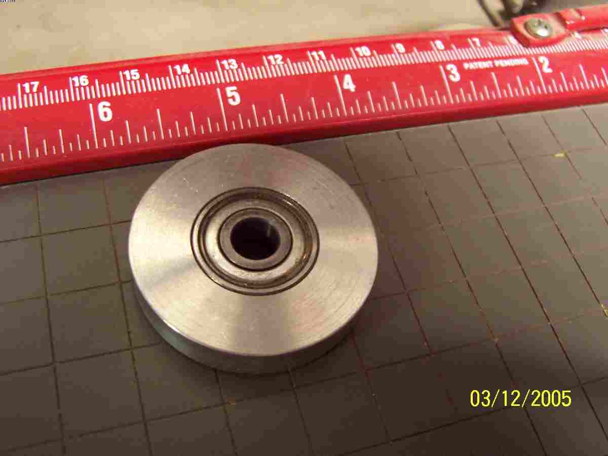

I wired my router with a reverse switch and I use a bit that can
be reversed also. This way I'm never cutting into the grain.
PostPosted: Sat Mar 12, 2005 1:51 am
Posts: 1534
First name: Nelson
Last Name: Palen
The reversing switch with reversible bit (left-handed?) sounds like a foolproof way to eliminate tearout.
My setup is a little unconventional using a 3-wing slot cutter of approx. 2" diameter. The pilots are aluminum rings with bearings installed. One ring rides on top of the body while the other against the side to establish width of cut.
I don't have the reversing capability but don't seem to have a problem cutting spruce. Not sure how it would work with redwood.
Nelson

I thought you'd never ask, Bruce!
The 1/2" shank is hidden behind the upper pilot. The second photo shows one of the aluminum pilot discs with bearing installed. I made up two sets of discs, one to cut the binding rabbet and then the second set for the purflin rabbet. I run these in a full size router mounted in an articulated arm with the body mounted on a turntable.
Nelson

Thanks Nelson, Okay, now to figure out what may be applicable. No doubt you had this machined? Thank you, Bruce

Bruce--I don't have the binding router set up right now but seems like I should have some pix around here somewhere.
I tend to forget that not every builder has a metal lathe and mill to make tooling but, yes, the aluminum rings are bored concentric with the OD.
The turntable setup is comprised of a large lathe that I built several years back for turning wooden bowls up to 32" diameter. This was prior to discovering instrument building. The lathe is primarily for mounting large faceplates on a heavy spindle driven by a DC variable speed/reversing motor. It has a pivot built into the base so that it can tilt onto it's back so that the spindle/faceplate becomes horizontal. This makes a good setup for mounting a 26" diameter sanding disc which works good for sanding the archtop bodies glue joint prior to joining the front and back plates. It also makes a nice turntable for other jobs including machining the binding/purflin rabbets mentioned above.
Another feature of the lathe is a 3" diameter tooling post mounted parallel to the spindle but outside the swing radius. This post accepts the articulated arm assembly mentioned above that holds the router. The combination of this arm with the turntable allows rotating the guitar body (manually) while following the profile with the piloted 3-wing cutter assembly.

Bruce--Yes, I do think the larger cutter diameter gives a better shearing action. You may notice also that the winged cutter has a sharp rake angle on the teeth.
I cut in only one direction, clockwise around the body. One cut for binding and one cut for purflin.
Nelson
