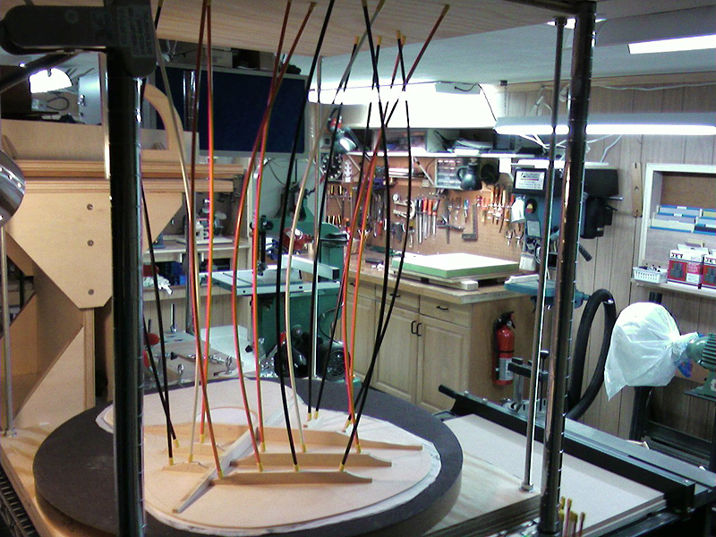

I rebuilt the deck using (2) 3/4" thick pieces of plywood for the top (laminated them together) and did the same thing for the bottom. I'm using 3/8" threaded rods that are 36" long, so lots of room to expand the height of the deck.
The 24" rods seem to be deflecting correctly now but when I used a scale to check I'm getting about 7 lbs rather than 8. When a rod is sitting on an average size brace on top of the radius dish the gobar is about 1" taller than the space from the top of the brace to the top of the deck.
Should I lower the top of the deck to increase the preassure until it reaches 8 lbs or leave it as is?

Update:

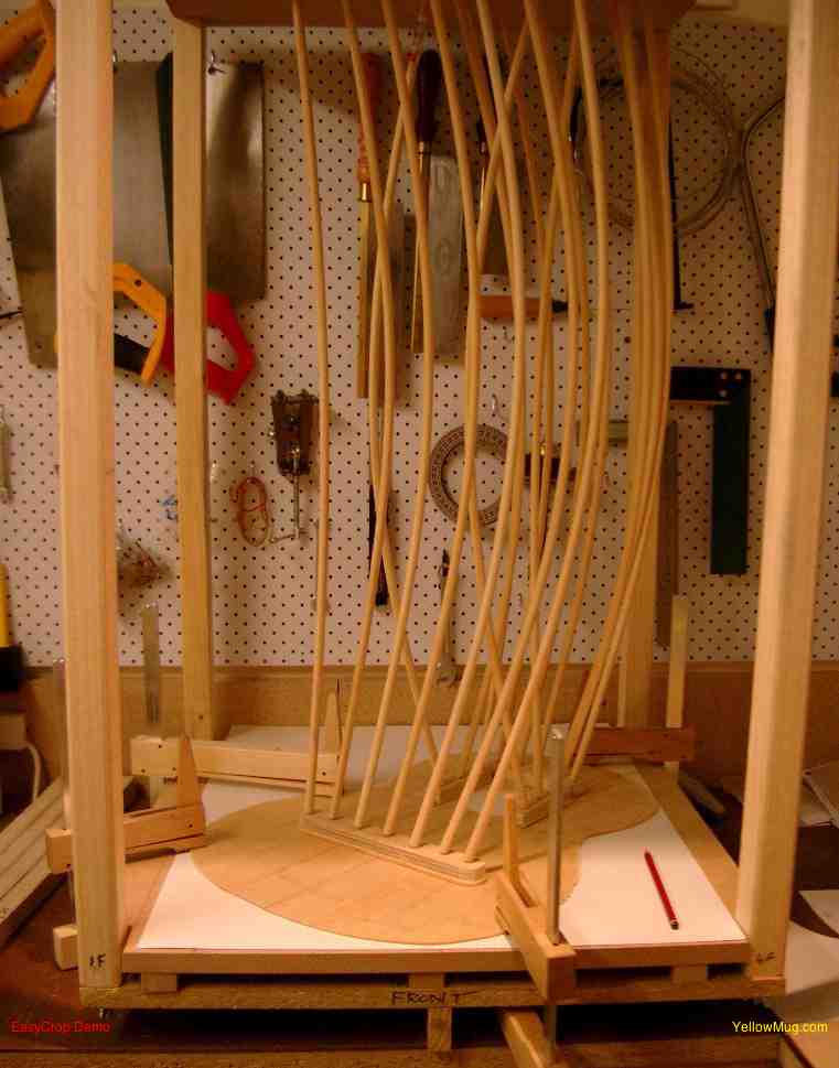

I just glued up the remaining braces using the new (and much improved) gobar deck. Lots of glue squeezeout without any exploding gobars! The 3/16" bars I'm using are giving the right amount of deflection (looks the picture posted by Colin - thanks Colin!
So thats how this thing is supposed to work! What a difference from this morning! The combination of a weak top and over deflection was definately causing the problems I was having. I acutally enjoyed gluing up those braces and did so without any colorful language!
Here's a photo of the updated deck in action.
