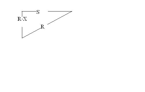

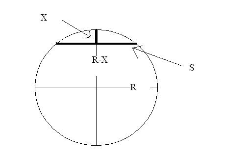

o.k. lost track of things here, but if any clarification is still needed:
using these drawings and the ever so useful Pythagoras thingy that says A^2+b^2 = c^2, you could easily create an arch that is related to a certain Radius(half a diameter).
this also means you do not need a,say, 14' long wire to create a decent arc that is a part of a circle with a 28' diameter.
every "S" has a matching "X" and they all relate directly to a given,pre-determined radius.
so if i wanted to draw an arch(28' Radius), and use that arc to make "rails" so my router could slide on them while routing out radius dishes, i could make a dish of a normal size(it doesnt have to be 28' "long").
say you average guitar body is 24" long, you just divide that lenght by 2 = 12"
so "S" = 12".
you want a radius of 28'.
so: S^2 +(R-X)^2 = R^2...
X= (2R +- sqrt((2R)^2 -4*(s^2)))/2.
since R and S are just numbers, this whole thing gets pretty solve-able.
if to be used, just make sure you convert the R's and S's to the same measurment system(all inches or all feet or whatever...)
in his book,Cumpiano, gives you the X and the S, so the R can be easily calculated as well.
hope this wasnt irrelevant!
Udi.
