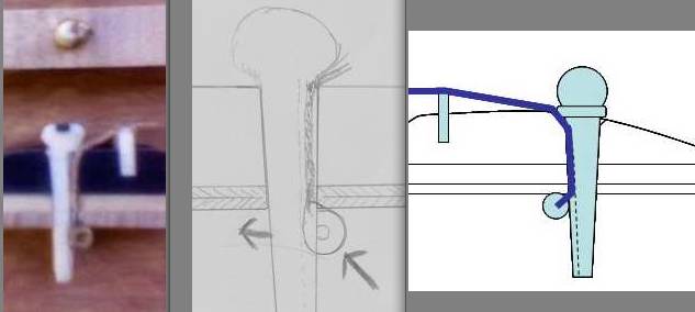

On slotted pins, the load is right on the edge of the hole, trying to bend
the pin back and slip up in to the hole. When I slot a bridge, the pins can
be pulled out and the strings stay in place. It's like a violin tailpiece. There
is virtually no force pushing on the pin, and no wear on the edge of the
hole.
There are of course still occasionally slotted bridges with damaged plates,
but in my experience they are usually due to use of replacement slotted
pins. Slotted pins (unless you turn them around) on a slotted bridge
are a double whammy, and will kill a plate in no time. The damage is so
predictable and consistent in my experience, that I really don't know how
any repair tech could determine otherwise.

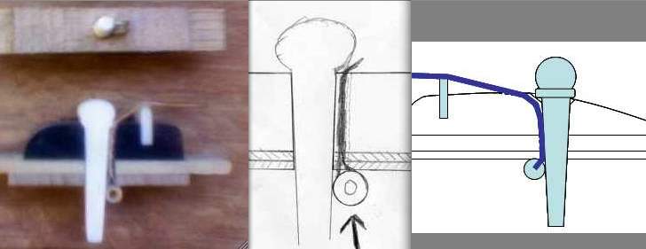

I was looking back at your drawings Todd (much better than mine btw)
and see a few changes that would help demonstrate my point, and may
even help explain some of our difference thoughts.
First, in the slotted pins notice that the ball end will almost always work a
corner in to the slot, rather than bumping up against the outer diameter
as in your drawing.
[IMG]../forum/useruploads/DavidCollins/2007-09-22_201248_1.jpg[/
IMG]
Look closely at the really bad photo of the bottom of the plate on the top
left. Notice that the one side of the ball end is more than half of it's
diameter over the edge of the hole, if that makes sense. This means that
it is not only the angle the string pulls at the ball end, but the ball end
itself is actually acting as a wedge with the upward pull of the string.
Every small bit the hole wears or the pin dents and bends means that the
ball end moving slightly further in. The ball end them makes contact with
the hole's edge at a steeper angle, or tangent to the circle, and becomes
and even more effective wedge to crush wood and bend the pins.

Second, bridge slots are generally cut to the width of the double wrap at the
ball end, but deep enough so that the string is not so sharply bent on
exit. Generally if you cut straight down to a good fit at the top of the bridge,
you will be a good enough distance greater at the bottom after considering
the pin's taper. The ball end doesn't push as much against the pin. I will say
that when I pull the pins to demonstrate, the string will often flatten slightly,
but still stay in place when retuned.
