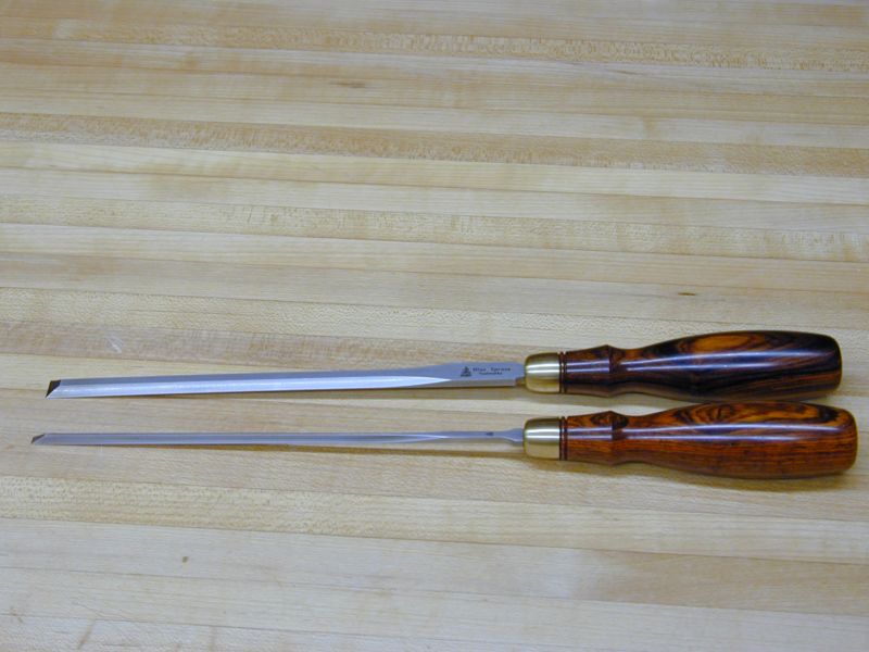

Attention-Attention Look at Hesh's picture. Check the logo on the blade just below the ferrule. This "glue clearing chisel" is genuine Ron Hock steel- as far as I know, the only run of chisels he has made. I have talked to him a fair number of times and begged him to make chisels. He is busy enough as it is.

[QUOTE=fmorelli] [QUOTE=Miketobey] Attention-Attention Look at Hesh's picture. Check the logo on the blade just below the ferrule. This "glue clearing chisel" is genuine Ron Hock steel- as far as I know, the only run of chisels he has made.[/QUOTE]
Mike, I'm slightly miffed. If you go to the LMI web site, it says their chisels comes out of a German foundry. If I recall, Ron does his stuff straight out of California. I'm sure I'm missing something
Filippo[/QUOTE]
I think the "Glue Clearing Chisel" is of a different ilk than the LMI chisels.  It is a Schneider Chisel.  It does not indicate where it is made.

On the "Glue Clearing Chisel, if you look closely at the marking below the ferrule, you will see Ron's trademark. Mine certainly has it and so does Hesh's. My beef with the lovely LMI chisels was the stupid coating and rounded backs. I sold them to a fellow forum member at a price that reflected that.mt
