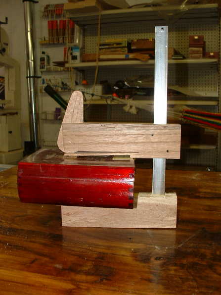

I forgot to mention this before, but wanted you to know that there is an inexpensive way to build your own cam clamps. I built most of mine out of scraps of 1x2 oak, and I roughly have about $2(US) in each one. It only took me about 2 days to build the last 40 of them that I built. Here is a picture of one of them. It isnt really pretty, but it sure does do the job of doing secure clamping!

As for the cam clamp.
I have thought of making it, because most of my F-clamp's throat isn't deep enough to reach the center part of the brace.
My only problem is getting that flat piece of metal.
Still trying to source for that metal and hopefully cheap.
I could only find cylindrical shape metal rod which doesnt make a good support as the cam might rotate around the rod.

I bought my aluminum bar on ebay for about $1/ft. It was the most expensive part of the project.

I plan to build some cam clamp once I managed to source the Aluminium bar.

Sen, if you can't find any aluminum bar and your F clamps are easily had and are reasonable, you might want to think about cannibalizing them.
