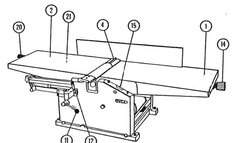

[QUOTE=Don Williams]
I second that and add the same for a jointer. That's an incredibly quiet yet dangerous tool. [/QUOTE]
I agree, Don.
Does anybody here know if there is an aftermarket Inca style jointer guard available to replace the 'pork chop' style? the Inca guard works well...don't ask.
