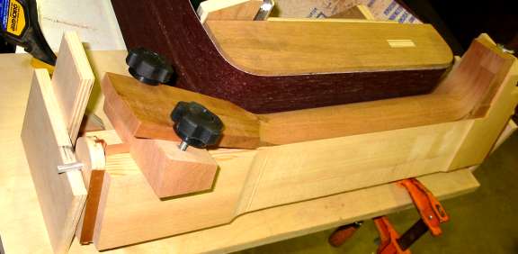

I use this dead head sander (idea borrowed from Charles Fox) for the neck and a spindle sander chucked in a drill press for the heel.
For final shaping of the transitions, I have an extra set of rubber spindles I use by hand. Varying sizes of sanding spindles is a great way to get the transitions fair.
http://www.chassonguitars.com

Kent - That is a great device!  Could you post a pic showing the whole set-up?

Thanks. It took some time to work out the kinks but it works great now.
I get asked about it a lot so I put this together...
www.chassonguitars.com/necksander.htm

Kent - I went to your site and must say that your neck sander is quite the real deal!
I was wondering if you had thought of using high mole weight HDPE on the dead head corners to reduce friction?
[QUOTE=Kent Chasson]
 and Mcain - sorry if this is a hijack!
Steve Walden

Steve, looks like I left out a detail. You can see it in some of the photos but I didn't specifically mention the graphite backer on the deadhead (available from Grizzly parts dept). That's about as friction free as it gets but it also caused some problems in the beginning as loose graphite from the pad coated the back of the belt and the spindle so the belt slipped badly. I cleaned both and added the pinch-roller/skateboard and it does fine now. Takes well under 5 minutes from rectangular to finished.

Kent, I bet that jig works great (love the skate board ajuster!), but how much of the dust generated are you able to collect?
