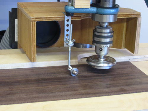

Todd, another idea -I built a hood for the dust collector and attached the hold down to that so that it doesn't move back with the fence.

Hey Scott, I was just going to ask what you guys use for dust collection on the drill press.That looks like a good set up. Anyone else ?
PostPosted: Sun Mar 12, 2006 1:57 pm
I was not using anything until I saw this set up above. I would make a run, shop vac on and at hand, vac the work board and take another swipe. The plane really throws the sawdust and drill presses are a hard item to air plumb................until now - Thanks Scott

If you use a collector behind the fence like mine, it helps to undercut the fence at the curved cutaway so that the heavier shavings are sucked under the fence. Otherwise, they will just pile up in that recess. The picture above shows a small cutout under the fence, but since then I have expanded it out the full length of the cutaway and up a bit taller and then reinforced that part of the fence on top.
It isn't a perfect solution, but most of the shaving are thrown back in the hood. If the shaving are too big and heavy to get sucked up, I know I'm cutting to deep.Scott Thompson38788.9328935185

PostPosted: Sun Mar 12, 2006 2:36 pm
Thanks for the clarification and info, I am going to build one this week.

Another dust collection solution is a floor stand.
http://www.hartvilletool.com/product/11678
