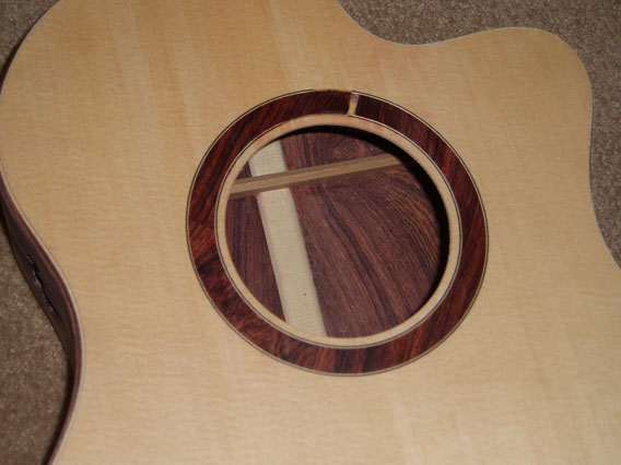

Serge, mine is actually not purple heart. It's camatillo rosewood, which is what I used for the back and sides as well. When you sand it though, the dust is as purple as Barney. It's hard to keep off of the spruce. Anyway, I thought it was wierd that we both had similar looking wood with the grain running diagonally, and you have a similar cutaway marked on there. Let me know how well the purple heart sawdust goes!
And yes, the fretboard will cover the gap (i think...)
PostPosted: Mon Mar 27, 2006 10:27 pm
Wow thanks Mike, that camatillo rosewood rosette sure looks nice and for i what i can see through the sound hole, that wood's got some nice figure! your cutaway looks great too. i hope the PH sawdust cleans as easily as when i thinned the piece with the drum sander, i'll let you know!

looks great to me.
the purple-heart "main ring" along with the "further away" black stripe make for a very unique appearance.
and i too, as other have mentioned, think the cutaway might be a bit too close to the soundhole.

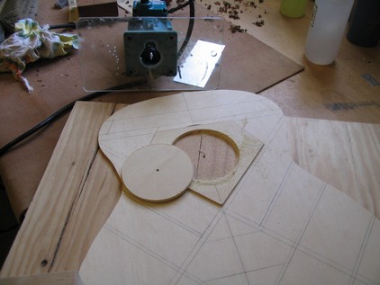

Josh, great idea of the routing from underneath,sure sounds like more top protection, do you have any pics of this patch and specs like thickness etc ?

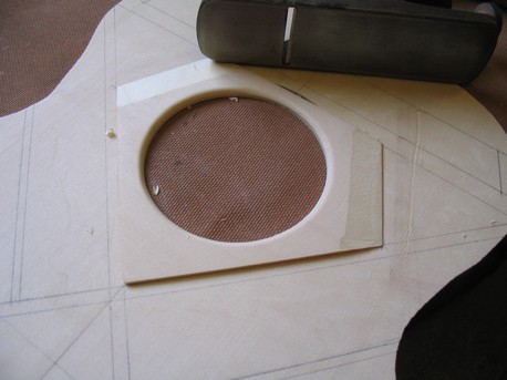

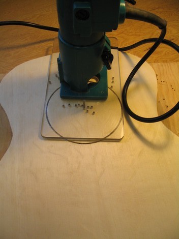

Here is my router which I use for all my sound hole and rosette work. The channel in the back is cut with a number of really light passes as you don't want to cut into the wood rosette. I go until i just touch it.
The patch is usually a little thinner than the top. The grain is running horizontal.
After it is glued in place I cut out the sound hole.
Then I shape the edges a bit with a plane. I also bevel the patch back along the inside of the sound hole so that it is not visible from outside the body when the box is closed up. The top in the picture needs a bit more bevel than what you see there.
I have found on occasion that when I flood from the top the glue doesn't always grab all the way around. This could be due to the fact that I use the accelerator to keep the glue from getting into the spruce. Once i flood from the back the whole thing is locked in place. Remember when you flood from the back to put some wax paper under the rosette. The thin CA will find its way through any little gaps. I glued my first top to the work board I was using . Fortunately the top came off without any damage, just had to remove a bit of glue.

Thank you very very much Josh for this! Very good explanations, i guess you thin your tops on both sides before, then make your rosette and then flip the top to do this last operation, the underside of the top, already thinned to it's minimum, you're then ready to glue that patch so you don't have to go back to planing the top again right?

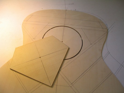

In the first picture the top has not been thicknessed (is that a word?). The top is thick when I install the rosette. Once the rosette is installed and levelled I thickness the top by removing material from the back only (drum sander). Once I like the thickness I draw where my braces are going to go. I don't draw most of my tops with that much detail. When I am trying a new bracing pattern I occasionally draw the whole thing so I can see how it will look. The pictures are one of my older patterns.
