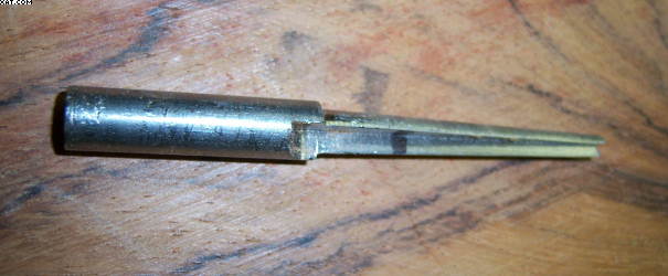

Just a FYI, I bought a reamer from LMI, and it came with no handle. Just a tapered shaft. I either have to use a pair of vise grips with it or chuck it up in my drill in order to use it. I have opted for the drill and I now have a mark on it so that I dont ream too deep. so far it is working, but I would rather have one with a handle...
PostPosted: Fri Sep 21, 2007 12:23 am
Ken, drill a hole in it perpendicular to the shaft and press in a cross bar. I've not seen that one. Appears it was made just for this job.
Pat, I tested my Hanson from ACE hardware. I does a near perfect job. No need to replace it, because it's working great. My Hanson looks very much like the General pictured on Page 1 of this thread. The 3/16 standard drill bit appears to work very well too. So I'm set for the next few hundred guitar bridge pins. This place always has me re-examining my mouse traps though, which is a good thing.
PostPosted: Fri Sep 21, 2007 12:38 am
Ken, I have that reamer. I turned a handle for it, drilled it the same same dimension as the shaft, put it on and then drilled another, smaller hole all the way through the handle and the reamer shaft to accept a pin which I peened over on both sides. I like the triple (?) fluted reamers from Stewmac better, but the handle on this one has stayed put.
PostPosted: Fri Sep 21, 2007 1:31 am
The handle on the middle one is a standard tap wrench handle.  That's what you are supposed to use.

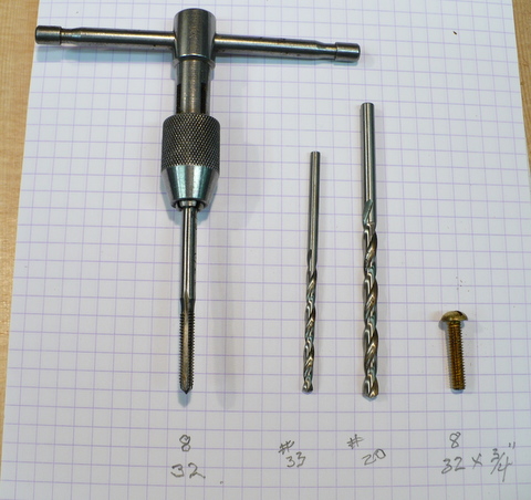

Waddy, I see no reason you couldn't use a screw for bridge pins. Cheap, easy to back out with just a straight screwdriver. Tools and materials easily accessible. You may have something here.

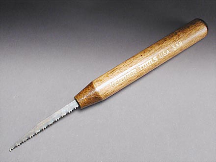

Craig, I tested the 3/16" drill bit last evening, after resawing a plank to the combined thickess of bridge, top, and bridgeplate. By the time the reamer got the pin to seat, by golly, it was 3/16" on the other side.
Okay, I have a question for you solid pin lovers. How do you make your slot through the bridge, top and bridgeplate? You know the one the string seats in and not in a pin slot. Inquiring minds want to know....
PostPosted: Fri Sep 21, 2007 8:38 pm
Posts: 698
We use one of these from Stewmac Bruce.
Easy enough to make one from a jigsaw blade but at 4 bucks why would you bother.
Bob Connor
Geelong, Australia
