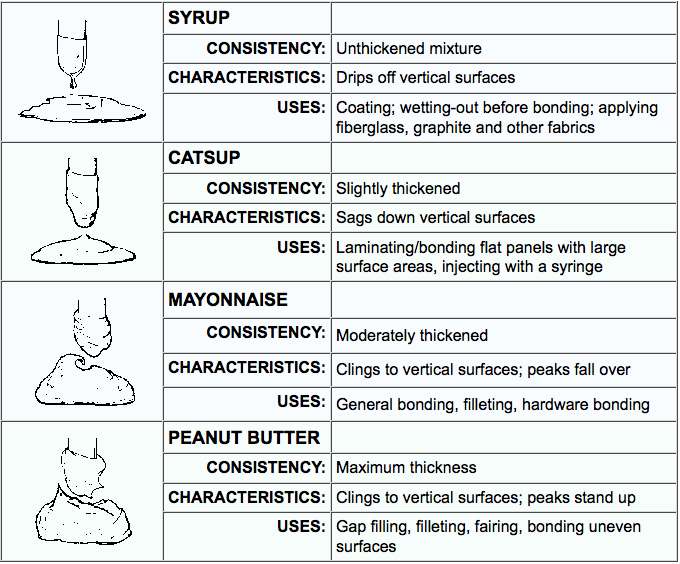

PostPosted: Tue Jan 01, 2008 10:00 am
How much thickener do you put in? Is it measured or do you just do it to a certain consistancy?
If it is by feel, what is the viscosity similar to when it is a good mix?
PostPosted: Tue Jan 01, 2008 12:23 pm
Posts: 2060
I just put it in until it reaches a certain viscosity. For something like a fingerboard joint I will typically stop somewhere between catsup and mayonnaise. Probably closer to the catsup.
It's wild when you first actually mix it. You add what seems like a surprisingly large amount before you start to see any significant change in viscosity. It seems as though the filler is just being absorbed in to some void or space in between the liquid molecules of epoxy. It just seems to take much more filler powder than I would expect to increase the viscosity, though I've never measured volume or weight.
