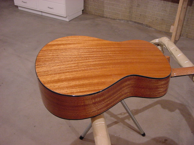

Here is a shot after I blocked out the first coat and added the second. This stuff is a little tough to cut. I used 400 grit wet with warm water and it took a bit of elbow grease! I will have to look into a better way to level between coats.
PostPosted: Sun Sep 16, 2007 1:32 pm
Posts: 1398
DynaOrbital with 3M Gold 280 or 320 grit paper. Piece of cake...
