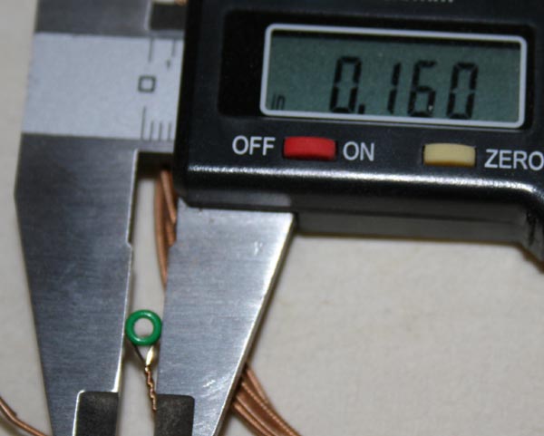

.26m.m. of slop where you don't want it. It's all in the details <G>
There won't be any slop.
a) you perhaps don't understand tapers, because the proper taper will leave no gap, and
b) you don't know how to measure a string ball <bg>
DAddario. Sure enough, if we measure this way, it's as you say, but since we must insert it through a  hole, we measure the widest part, it's, ummm, .001" smaller than 3/16".
It's all about the details, and getting them right.

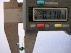

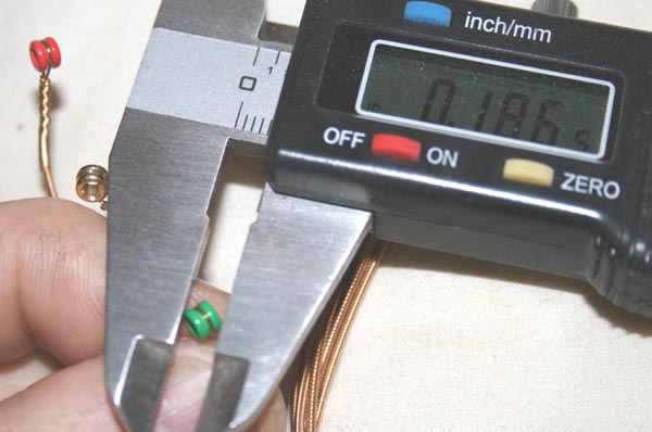

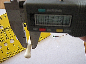

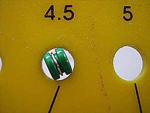

Grumpy ! I've got better things to do than argue about the size of balls !
BTW I can, and did measure these correctly,, You didn't !
Those who "try this at home" , will quickly see that I am correct.
These pictures are crap I know , but you'll get the idea , and as I said ,,,go check.
D'Addario balls are .178 "
Stewmac 5 degree pins ,.5" down from the collar are .178"
Take a .3125 bridge plus soundboard thickness of say .115 , plus the thicknss of a bridge plate ,say .1. you have a thickness a little more than .5" .Now that's with a 5/16" bridge . you cant get too much thinner than that.
       .178  &n bsp;  Correct measurement
passes through 4.5 m.m (.178 ") hole. Correct measurement !
.178"    correct measurement.
Anyone who checks these will see that I'm correct.
Go measure again Grumpy !!!
