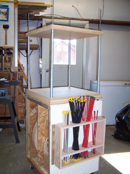

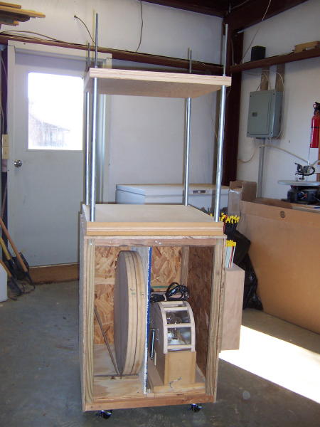

Hesh mentioned something yesterday about getting his deck up off the floor. I thought I'd show what I did a couple of days ago. It's not pretty as it was made entirely of scraps, but it's not bad and it will work great.

That looks great. Very compact and useful. I like the go-bar and dish storage. I'm going to have to fix mine up like that!

Very nice, Ron, especially the go-bar rod storage on the side.

Looks Great Ron,
It will allow you to wheel the whole operation out of your way not in use, very clever.
As a side bonus, if the guitar thing should get a little tired, you can quickly and easily convert it to a hot-dog or lemonade stand

Great idea Ron!!! Love your design for this tool.

Great setup Ron. I really like the storage area for your side bender and dishes. It has gotten me thinking, that one cabinet is actually a complete bending, glueing, and sanding station. Now thats what I call efficient use of available space. Don A39083.7439236111

Very nice design. I've been thinking about something similar, except my go-bar deck is a little shorter than yours, and I'm going to sandwich my DeWalt planer in between the storage below and go-bar deck above. I may have to go to horizontal dish storage to keep the height reasonable, so I think I'll have to put the bender on top. Glad I saw yours to help me envision what mine will look like.

What is the surface material in the bottom of the go-bar deck, it looks like it has a gloss to it?
Also, looks like threaded rod with pipe around it. I don't know what you call the nuts that are "T" shaped with barbs on the flange that cinch into the wood when you tighten them.
Hesh, the bottom is 3/4" plywood sandwiched between 3/4" MDF. There is no finish on it.
The threaded rod is in electric conduit. Those T-nuts will work well. I didn't have any, so mine is fastend with regular nuts, countersunk into the outermost layer of MDF. I also countersunk the conduit about 3/4" into the top and bottom of the deck. Very sturdy. I left the all thread long on top because I wasn't sure how much room I needed to work in there. It's set at 23 1/2" high now and that works great for me. It would be simple to raiset the roof if needed, though.

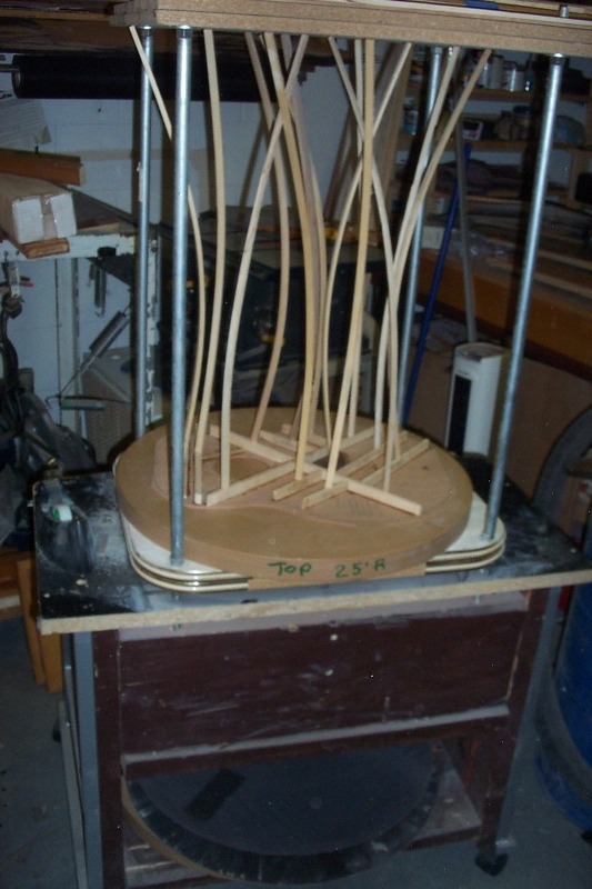

Thought i'd show off mine if you don't mind Ron, i store my dishes on the bottom shelf and the glues and hot pot plus the food warmer tray on the top one...
When not in use, i use the top deck to store some clamps too but will definitely build me a special rack for those in the future!

Looks very multi-functional, Serge.
