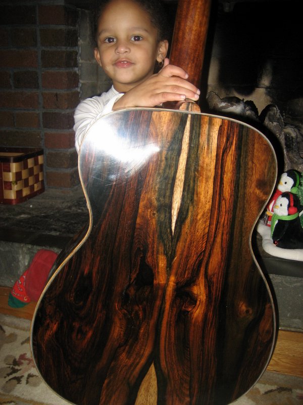

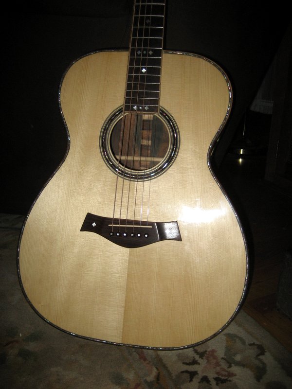

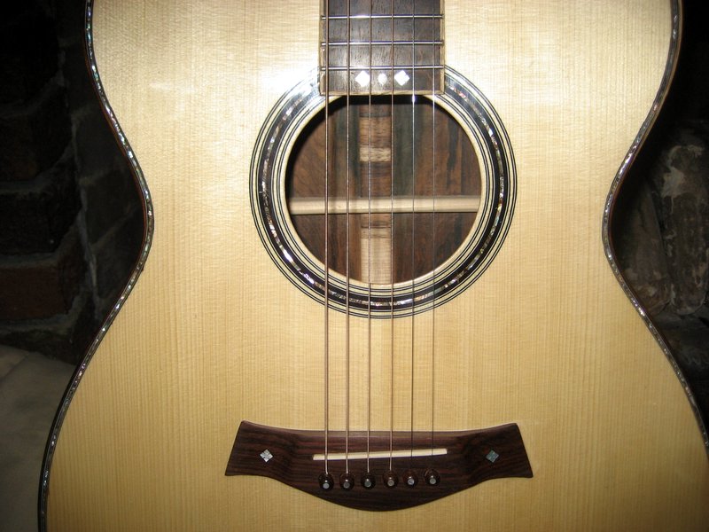

Well I finished up this weekend. I think this is my best effort so far. I guess when I look at completed guitars that are being used by friends and family, and hanging on my walls, this would be officially #16
Sound is still evolving but very happy with results and looking forward to sound improving over time. Pretty well balanced with decent sustain, satisfactory volume and good base.

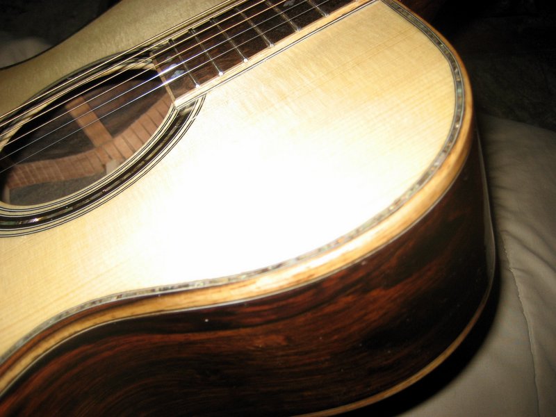

Back/Sides are Brazilian thicknessed to around .10 and sides at .08. Soundboard is Adi and thicknessed to around .095 with light bracing. The bindings were cut offs from the sides (heartwood) with some dark color blending into the heartwood.

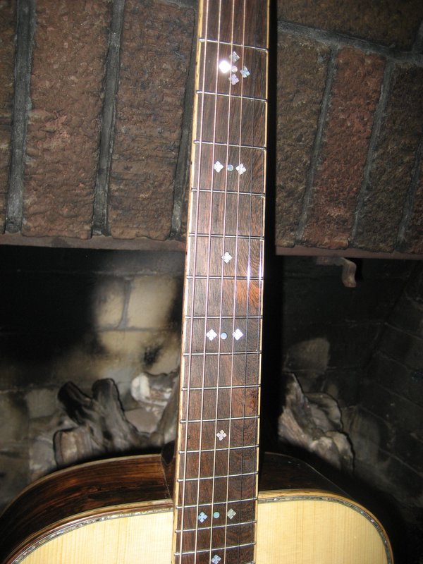

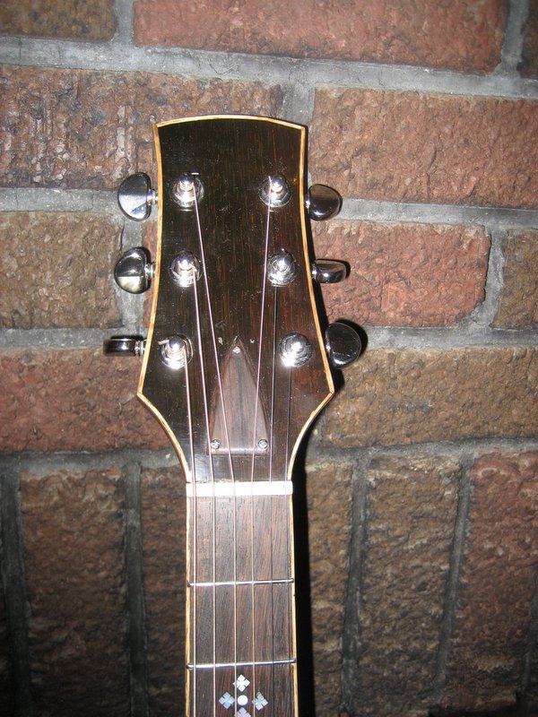

The neck was a rough blank Guild bought on ebay and I shaved the headstock down eliminating the Guild crown. Fretboard and headplate veneer are also brazilian with MOP diamonds inlayed.

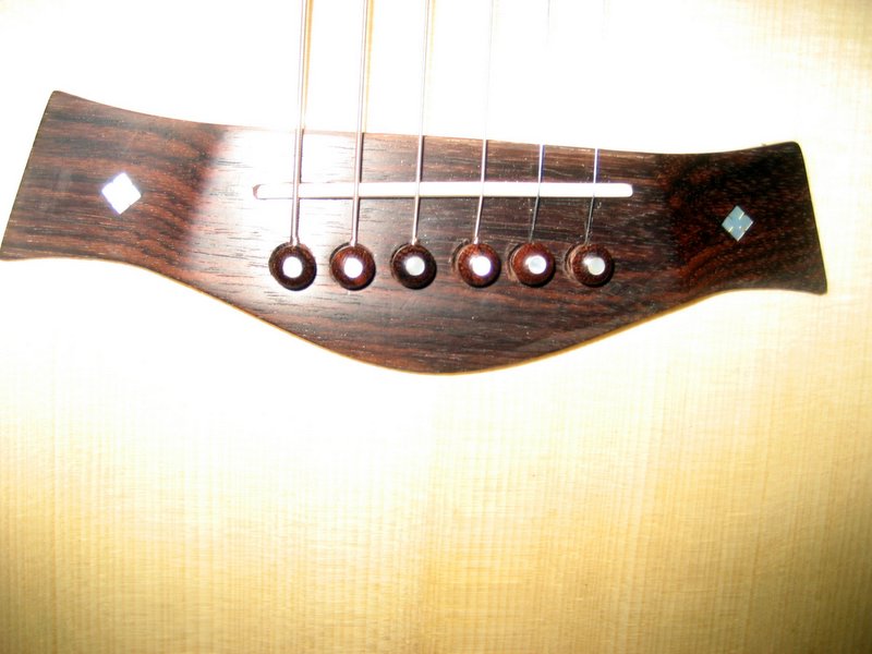

I made a Brazilian bridge copying Taylor's design but the color match wasn't as good as an EI bridge I had on hand and had used for my specs so I ended up using the EI rosewood Taylor style bridge. Bought a few of these bridges on eBay from a fellow in Australia. Very nice quality and think they ran about $8 ea.

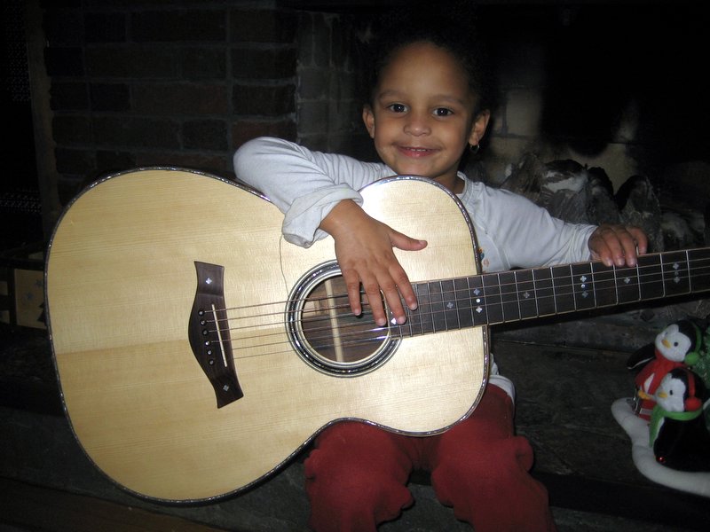

I have my apprentice modeling the guitar. Her name is Miana and she is my grand daughter. We tuned it up tonight and had her singing Erie Canal
Some day I have to read the instructions on this camera to improve my picture taking. Flash always messing up the pictures.

One question. Where the neck meets the body, there is a very slight gap at the top of one side of the neck. Thought I had it perfect when I fit her up but now I have a slight gap. Someone mentioned to me at one time they would use Crayons and fill in a gap like this with no need to finish. Anyone ever try this?? Wondering if I should soften up with heat and then force the crayon wax onto the gap or use something else, or just leave it alone.

She is beautiful! The guitar is pretty also. I really like the rosette. Is that your body shape, I like that. Nice clean lines, everything flows. What kind of finish do you use? Clinton

You are kidding about the crayon? I have heard of using stick shellac or burn in lacquer to fill small gaps if that is what you mean (mainly the ends of fret slots on unbound necks).

Your model has a positively heartwarming smile.

I've never used it on guitars yet (only built 2 ), but it's common in furniture work to fill small cracks/splits/holes with wax. You can buy special colored wax "crayons" in most good hardware stores, or online at any of the woodworking vendors. They come in many different colors in order to match the wood you are fixing. If you do this, go darker than the wood around the crack. Light lines show up against the darker background, darker lines fade away. You don't want to call attention to the area...

1 question, which I hope doesn't sound too stupid-
what are those bridge pins? They nearly look like amber horn pins from John Mickelson. But maybe not?

The pins are just some rosewood pins with pearl dots I picked up on ebay along the way.

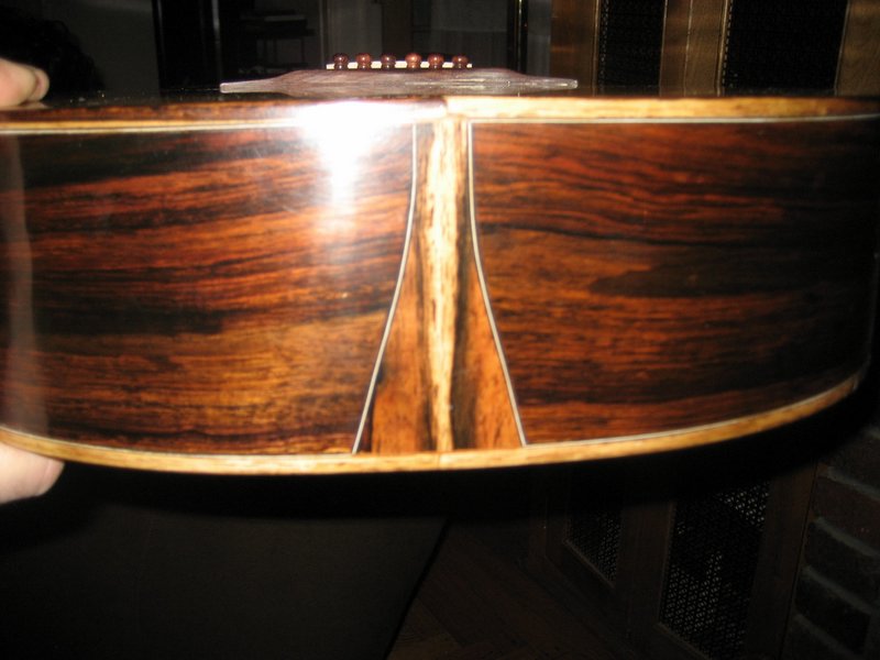

Hesh - that creative touch of reversing the end graft - pretty clever heh?? Now for the truth - you probably remember I did this once before by accident and was kicking myself. Guess what - I did it again !!!!! I kind of liked it in the end but I always seem to have that prblem of forgetting to check which end is up!! Boy did I feel stupid when I realized I had made this same mistake.

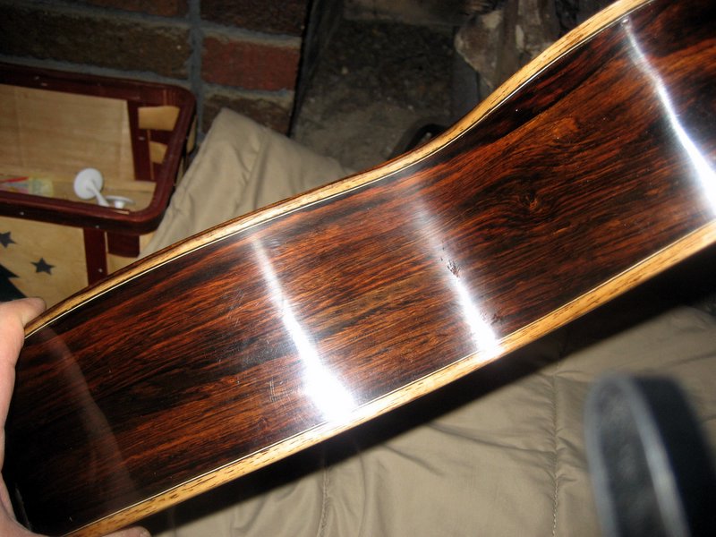

Someone asked about the finish - just lacquer. My finish process included a couple coats of shellac followed by paste filler from LMI followed by another coat of shellac, followed by 5 coats of lacquer, level with 320, additional 5 coats, scuff and buff.

The end graft inlaid upside down from my original design plan and one result is the base of the inlay does not align perfectly with the heartood on the back.
Slight gap at the neck joint which still needs to be filled. Thanks for the tip on going darker with special wax crayons. Will look into that
Couple minor defects on the finish. Needs a little more drop filling and thinking I will take all the hardware off in a couple of weeks and do another scuff with 600 grit and apply maybe 2 more coats of clear, blending into the bridge area to avoid build up around the bridge.
