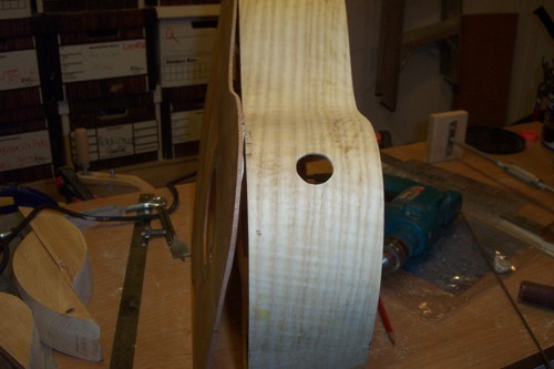

PostPosted: Sat Dec 30, 2006 5:45 pm
Chris, this is no 3 for me and i decided to experiment, i cut this hole after the sides were bent, i glued a very thin veneer inside before cutting the hole.
All that's left for me to figure out is a way to bend a very tiny strip of ebony to match that hole size!

PostPosted: Mon Jan 01, 2007 6:42 pm
[QUOTE=Hesh1956] Serge I was thinking about how one might bend a thin piece of ebony or any wood for that matter to line the opening of your sound port.
What it you went with veneer thick ebony and rolled it kind of like a dipolma or a ring napkin holder. Insert is in the hole, insert a baloon, and blow up the baloon to act as the clamping caul for the ring. Mark how much over lap you have in the ring, pop the baloon, cut off the over lap and repeat with a new baloon.
Since you can get to the inside of the side now you just sand it flush as you would with the outside of the side.
Be aware that I don't know what I am talking about here and have never done a sound port - it's just an idea and perhaps others can build on the idea to make it work better?[/QUOTE]
Thanks for the balloon tip Hesh, i'll give that a try, the box is closed but it shouldn't be a problem to sand it down to side thickness with one arm inside the box, i believe! I'll try to cut a very thin strip of the leftover ebony binding that i have, thanks bro!

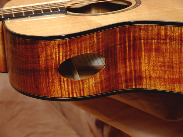

PostPosted: Tue Jan 02, 2007 3:17 pm
Posts: 3005
Sam, here's one I did exactly as you describe.
