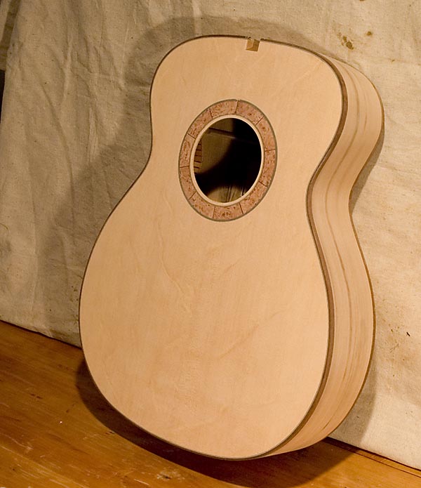

Found a bit of time during the holidays to glue up the sound box and install the bindings (Myrtle b&s with Walnut bindings). I ended up with a couple small gaps at the tight bends at the waist and upper bout but they disappeared with a little glue and sanding dust. Do many of you use clamping cauls in this area when installing the bindings? Given the soreness of my thumbs the next morning, I don’t think I would be able to increase the taping pressure next time.
Well, its time to pull up anchor and sail into the next uncharted sea – The Neck.
Hope everyone is having a great holiday.

Way to go!! Looks great!!
Nice Myrtle....
PostPosted: Wed Dec 27, 2006 2:53 pm
Posts: 744
Very nice job!
Brad
Avon, OH
PostPosted: Wed Dec 27, 2006 3:03 pm
Good job and outstanding wood. I love that myrtle. Nice combo.
PostPosted: Wed Dec 27, 2006 3:59 pm
Awesome wood, looks really nice so far Doug
PostPosted: Wed Dec 27, 2006 11:58 pm
Great looking work!
PostPosted: Thu Dec 28, 2006 1:00 am
mmmmmmm....m-m-myrtle...*drools*
Nice, clean work!!!

Nice work, Doug.
Sore thumbs and fingers just seem to go with the territory, don`t they?

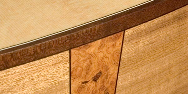

That is so pretty! I love the way all the woods work together - it's simple and understated. I love the look of myrtle with the walnut bindings, the burl trim and the bearclaw top. Just awesome - I can't wait to see this with the neck and finish on it.

Your guitar looks fantastic! I've been having the urge to try some myrtle
myself. Wonder how it would sound with a redwood top?

Great Job ! What burl are you using for your back graft and rosette? The Myrtle and bearclaw top are first class. Send us more pictures as you move onto the neck.
