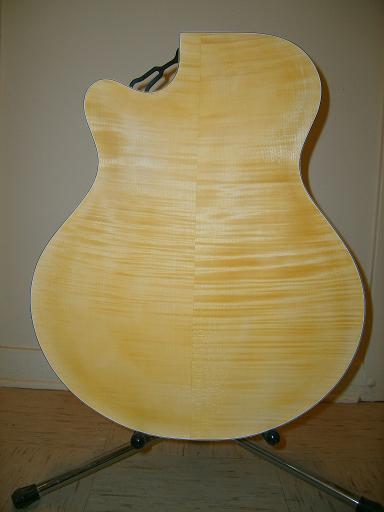

Bruce Dickey requested that I post progress pics of my archtop, so here it goes.
B&S: euro maple
top: Sitka
neck: Bigleaf Maple
FB: Ebony
Inlay: Gold MOP, Black MOP, River pearl, African Blackwood

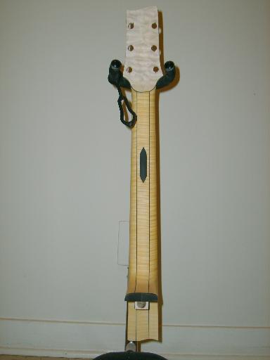

I built it mostly from the benedetto book. The major differences being, a bolt on neck and truss rod adjustment through the head stock using a long ballend allen wrench.
Right now it is just stained, I will try to finish it in the next couple of days.
Matt
Matt Jacobs
"Don't tase me bro"

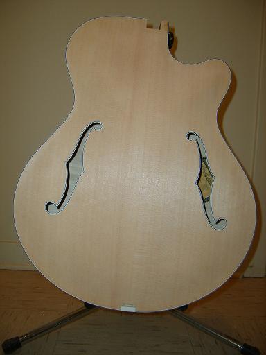

Beautiful...the binding on the f-holes really catches my eye for some
reason - it isn't obtrusive, it just looks really nice. I also like the inlay on
the back of the neck.

Thanks for the compliments Jay. Sorry I don't have any previous progress pics, This is my first Archtop so I was concentrating on getting it done. Plus I was afraid to bring my camera in the shop beacuse of all the dust from the angle grinder I used to carve it!

Are you going to access the neck bolt via the endpin hole? (allen wrench with extension)

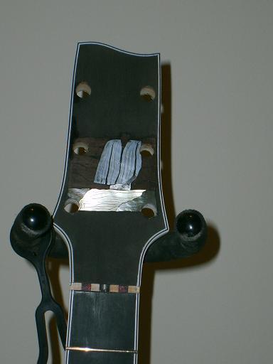

That's shaping up very nicely, Matt! So what's the story behind that back-of-neck inlay--a tragic rasping accident? Looks cool, BTW.

I too am interested in how you made the bolt on neck.

The tuner holes look a little close to the edge of the headstock. Will the tuning machines hang over the edge?

As far as the bolt-on neck it is pretty much a standard mortise and tenon joint with threaded inserts in the end. To access the bolts I use a 24"long x 1/4" drive extension through the endpin hole. It was a little tricky to maneuver at first but now it is a breeze.

Carlton- The neck inlay was totally intentional .
Actually I was using a friend's router table to route the truss rod slot, when the bit climbed out of the collet and went through the neck.
