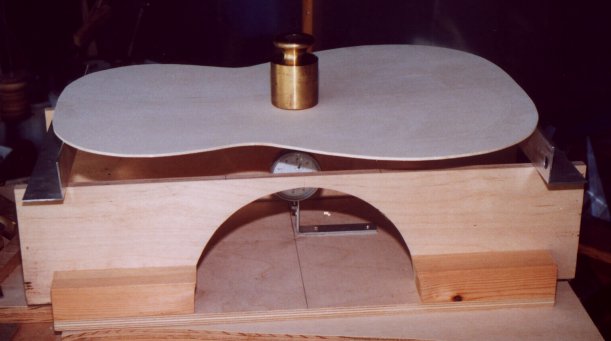

Posts: 993
Thanks for the input fellas! The stiffness arguement is valid and made me think of another question. Have any of you who built an SJ size guitar done any deflection testing with Lutz spruce? A deflection test in several directions might be a better way to judge stiffness. After all, I have built a bunch of classicals so judging stiffness isn't completely foreign to me. Also, after remeasuring the top, it is closer to 2.2mm in most spots so final sanding etc. should still leave it around 2mm+. I know you guys said don't use it, but you're right about using it as a learning opportunity. Since this is my first SS, I know I won't be selling it, so this might be a good chance to push the envelope (inadvertantly) to see how thin I can go on top. After all, it's unlikely I'd go this thin again on purpose in the future, so this might be the only chance to really learn from a top so thin. I like the idea of building two side by side--I think I might have to try that.
Cheers!

PostPosted: Sat Jan 06, 2007 9:24 am
Posts: 130
John,
Like most wood, I have found Lutz to vary quite a bit even in the same
billet. I have some tops that are really stiff and others from just 3/4" away
in the same billet that are pretty floppy.
My senses aren't nearly as refined as Ervin's so I still take deflection
readings as I sand them down to my final thickness. Two Lutz tops I
recently sanded to the same stiffness varied in thickness by 15% or so. By
the cube rule, we know that if the wood had been identical, the thicker
top would be 50% stiffer. What I'm getting at is each slice of wood has to
be evaluated individually.

PostPosted: Sat Jan 06, 2007 9:27 am
Posts: 2711
Location: Victoria, BC
Last Name: Abercrombie
[QUOTE=dgalas]
The problem
is there is no easy way to pass that 'stiffness' number along like one can a
thickness number.
Dave-
You're right in that it is certainly more difficult to gather stiffness info in a standardized way.
However, I think it would be great if we could agree on some simple deflection test so that we could get some numbers and start being more systematic.
There was an article in the GAL about a mandolin class where the tops/backs were carved to a stiffness/deflection standard- I thought it was interesting.
Basically we'd have to decide on how the plate is to be supported, the amount of weight to be applied and then measure the deflection using a dial indicator.

PostPosted: Sat Jan 06, 2007 10:23 am
Posts: 130
Thanks Dave - but at least I look good in a bikini....... [/QUOTE]
How thin is too thin?
PostPosted: Sat Jan 06, 2007 10:46 am
Posts: 993

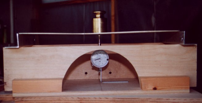

[QUOTE=James Orr] Couldn't something similar in concept be put together to measure stiffness as long as the tops were of the same width and length? [/QUOTE]
I don't think you even need to have the tops be the same length. As long as the supports on both ends are consistently spaced, say 18 inches, it wouldn't matter how long the top was. Here's a pic with a 1kg weight testing deflection. We could really get a lot of good data if everybody would do this. If the OLF created a database of deflection testing to some standardized specs, it would be invaluable. It only takes about 15 minutes to build a rig like this, and about 10 seconds to measure a top.
