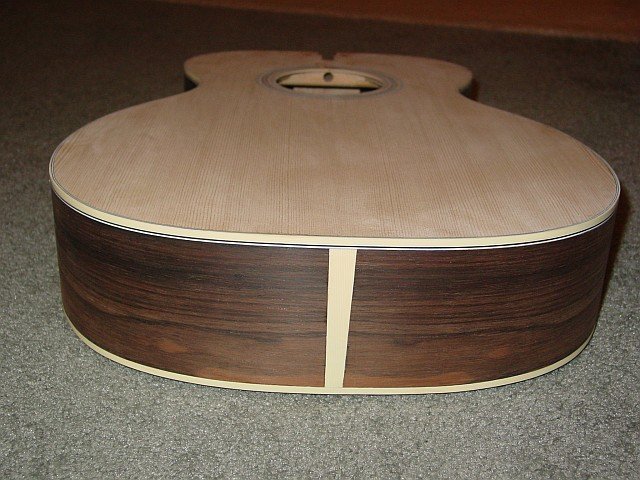

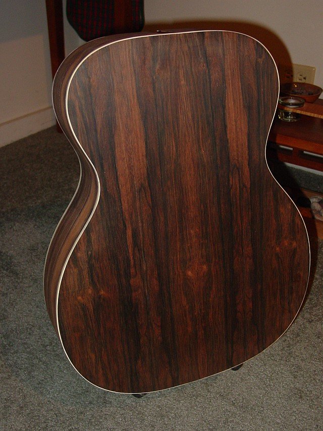

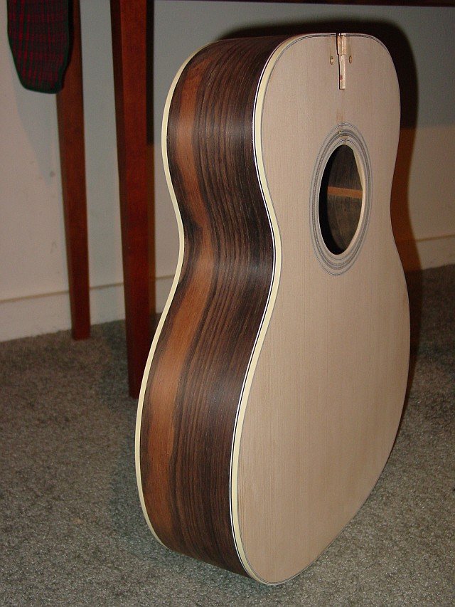

Just thought I would share pics of my first body, which is pretty much complete. It is not perfect by any means, but it still looks pretty good and this is so fun I don't mind. Need to fit the neck so some adjustment is still being done. The routing and binding went well with only a couple of microscopic gaps...filled with CA and scraped and sanded easily. Boy is this fun. No finish applied yet and still debating on which way to go.

Beautiful back & side wood even with out the finish!What's the body size?

Thanks guys for the comments and advice! CAn't wait to see your oil finish, Mike!
This is an OM size, for 14 frets. The top is solid Sitka and the back and sides are laminated BRW. I am on a serious hobby budget and since this is my first instrument, I wanted to not spend a lot to learn on. However, this has gone so smoothly, I can't wait to start my second and will probably go with Indian Rosewood as it is so pretty. As Ronn says, it is addicting!

Steve - laminated brazilian you say - well you certainly book matched it extremely well. Looks great!

The BRW came from John Hall. I have to say, it is a little different from solid wood to work with. It is more brittle because of the thinness of the veneer and I am afraid to sand much. I am going to have to live with a few light planer marks because I don't want to sand through. There is one spot where the join shows more than I like. Still, the routing for the ledges went nearly perfectly, so it is not bad compared to lacewood maybe for fragility.
