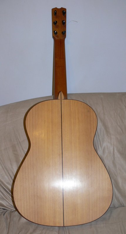

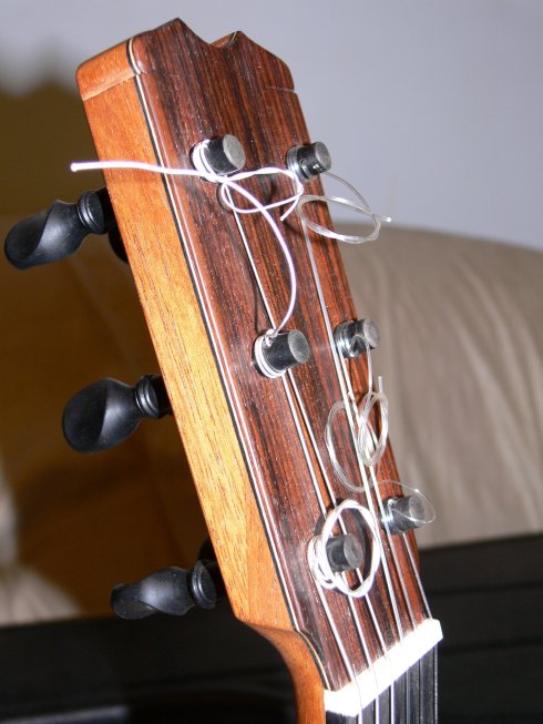

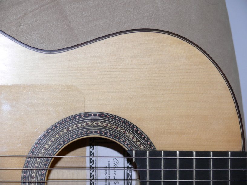

Hi folks.
Here's some pics of my latest guitar.
This is guitar number 2
Monterey cypress back and sides.
European spruce soundboard
Spanish cedar neck
I had a go at french polishing and need a bit more practice.
Styled from a half moon conde.
And it roars like a bull
If only i could play..Hahaha!!
WOOOHOOO!!
Claire
Claire39085.2121296296

Nice work there Claire,
Did you work up the tuning pegs yourself?

Lovely instrument Claire, oh and welcome to the forum, I just love the simplicity of tuning pegs. Once you get used to them the 1:1 ratio is easy to master, and they just look right on a flamenco. I make my own from ebony or one of the fruit woods.
The French polishing looks fine to me, you're not after a 'nitro gloss', just a nice sheen to set off the wood, especially on a guitar like that.

Thanks for the compliments everyone.
I like Udi's guitar....woohoo.
And I'd love to see some pics of max's and jim's guitars
I've been looking at pics of colin's lutes, and thinking how tremendous!!!
I didn't make the pegs or the rosette myself.
Rosette making is something i really want to learn.
I've already ordered the timbers for my next guitar, and some hide glue to explore with.
Another flamenca blanca, this time with geared tuners for simplicity, and to keep the theme of the guitar I'm copying; one of those old smaller bodied sixties conde's.
Thanks again everybody.
cheers,
Claire

Can you give us some details?
Top thickness?
Bracing pattern and demensions?
neck width -nut & 12th fret
I love Monterey Cypress!
Keep up the great work!
Mike Collins
www.collinsguitars.com
Mike Collins

Hi Mike.
thanks for you your post:)
Guitar is 52mm at the nut, and 61 at the 12th.
I made the back of the neck a bit flatter than the typical conde.
On my guitar the top is thicknessed 2.2 mm at the sound hole tapering to 2.1 at the widest part of the lower bout.
Seven fan braces. They started out at 5x5mm before fitting, and i chiseled them on the soundboard to a triangular profile to about 3 mm in height.
I left them rough and didn't sand them.
Perhaps 15mm end relief each.
My thinking was to keep the soundboard as open as possible.
so no lateral bottom braces.
And keeping the fan struts as close to parallel with the growth rings as possible.
I also used the stiffest bracewood i could find for the struts and i ended up useing sitka spruce totally by accident because i had no idea what i was looking at at the time.
But it worked.
I also glued the tentalones on the soundboard right up against each other to make the soundboard/sides coupling as stiff as possible.
No bridge plate.
My old conde has no bridge plate so basically i copied that.
I made the sides as thin as i dared and then some.
I think they'd be about 2 to 2.2 mm thick.
I just tapped them and listened so i don't know the exact thickness, but they're very thin
It has a good flamenco tone, its percussive, it honks and its loud.
BUT its also a concert sized guitar and i think what you gain in volume with a BIG guitar you loose in dryness.
There are overtones that are amplified that i think are to do with the size of the thing, and i'd prefer it to be a bit flatter sounding.
I think a Barbero is a great size pantilla.
I've played a real Barbero and a copy and i think they were both outstanding.
Cheers,
Claire

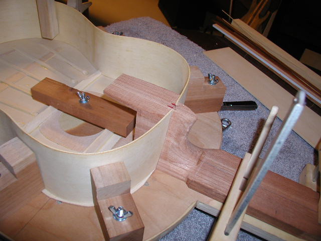

Jim, I am also building a Manuel Reyes (just starting, 1st guitar). I had recently emailed Tom with a question on the plan part of his response was the following:
"But the plan is drawn flat from the nut to the bottom of the guitar and the neck has to be lifted about 2 mm up to get the playing angle right."
In reviewing his notes in American Lutherie number 84, where the plans were originally published, he does reference angling the neck forward 2-3 mm at the nut. Did you take this correction into account. I am struggling with the best approach to build this in, as once the neck is set there is really no adjustment. Do I angle the neck forward by this amount, or could I simply increase the height of the nut.
I am looking forward to seeing you final picts.
Darin
PostPosted: Sat Jan 06, 2007 2:00 am
Joined: Fri Sep 01, 2006 12:32 pm
Posts: 23
[QUOTE=DarinMcC] Claire, awesome picts you have to be proud of such a fine accomplishment.
Darin
If I understood correctly...
Couldn't you just taper the fretboard 2mm toward the soundhole when thicknessing it? That's what I've been told to do on my first guitar (flamenco - Santos Hernandez based... curing right now) by some flamenco builders.
