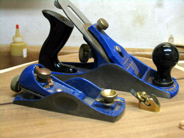

I use 3. I think you will have to decide which would be the best to start with. The two blue ones are Record. They are great planes for a resonable price. About $100 and $50 as I recall. The big one is great for planning plates to thickness, and joining parts. The block plane works great for things like radiusing braces, trimming the sides and most smaller jobs. I use the Ibex for shaving braces.

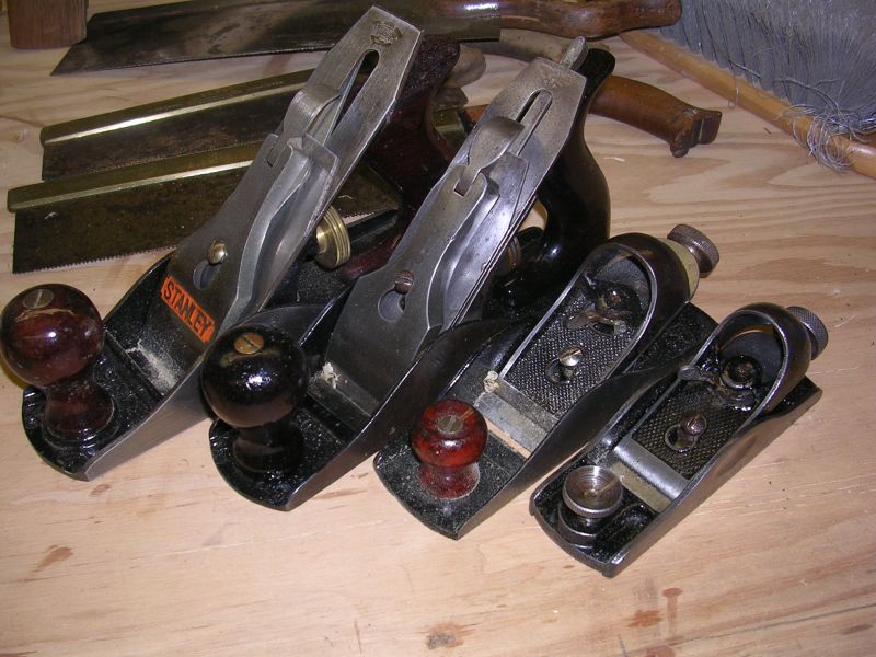

City: Selma
I would also say to focus on an older Stanley, Millers Falls or Sargent VBM. You can find decent ones on eBay pretty cheap... If you know what you're looking for. If not there are several folks that will sell you a already tuned up old Stanley for much less than a Lie Neilson or even Veritas.
LN and Veritas are, by all accounts, both great if you can justify the cost. If not, again older Stanley ETC. The newer Stanley are junk. They can be made into a decent user but it will take a lot of work. I've also read that Record is no longer in buisiness, having been bought by Irwin(I believe) and now being made in India. New ones I've read are not great quality now.
As to size, a number 5 is 14" long so for me a bit long for thinning plates on a guitar and certainly too large for working on a uke, or so I would think. I prefer to use a number 4 or even a number 3. The longer plane would be better for jointing plates, but for this I use and old 22" Stanley transitional (Wood and metal) plane that I bought for $9 on eBay.
Patrick's Blood and Gore site has tons of useful information as does the Plane Dating Flowchart site.
I'm not sure the tools for sale at the blood and gore site are tuned and ready to go though he may offer that service. You might check
Tools for sale
If not shoot me a PM and I'll try to come up with a few guys that do sell pretuned old planes. I know there are a few out there I just don't have their info handy.
In the end you should be able to get a decent older Stanley, Millers Falls, or Sargent VBM for $40 - $50
Also check out Hand Planes 101 and Brass City RecordsRCoates39089.7142708333
