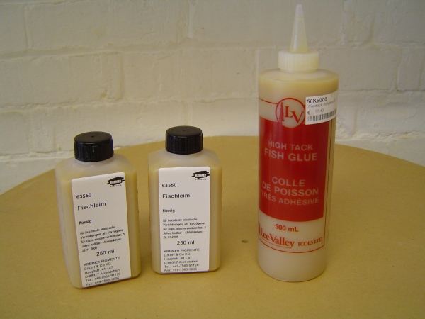

When I took the Romanillos course and we were using the fish glue in 2001, it was Gerhard Oldiges who reccomended and supplied the fish glue. At that time Jose seemed to already have quite a bit of experience and confidence in it, and we treated it basically like titebond.
I asked Gerhard for a source, and he told me he got his from a local piano maker or repairer in Germany, but that the stuff Kremer pigments sells is very clse or exactly the same.
I don't know if the Lee Valley stuff is the same as the stuff I am using from Kremer, but people are posting some experiences that are different from mine, and treating it differently then how we did on the course and how I have ever since.
It is very high tack and seems to have the same tendency as HHG to draw pieces together as it shrinks, though not quite to the same extent. It does not require more than an hour of clamping pressure, and actually creates a very strong bond within minutes of clamping. The high tack is very useful for the gobar deck, so braces dont slide around once placed.
I have one bottle that has been sitting here for over two years, and I cannot make any discernable difference between old and new in breaking a finished joint.
The stuff I have also is very handy because like hide glue, to reglue something you do not need to remove all the glue, since adding more glue "reactivates" the old glue - making for easily repairable joints. This also makes it useful for rosette making.
Like I said, I don't know if the Lee Valley stuff is different, but based on my different experiences I would guess that it is.
The Kremer stuff is made in Germany.

Thanks Joshua, it is the Lee Valley stuff I have got. It seems to be pretty good, but I will get some of the Kremer glue over and do a comparison. However, judging from the results with in my basic tests of the Lee Valley fish glue, I would be quite confident in using it.
When I glued the test pieces in the Go-bar, it produced very fine joints that have resisted my attempts to break them at the joint.
High humidity is never a problem here and I don't play the guitar in the bath, so there shouldn't be any problems with water resistance.

I just received my fish glue from Kremer in Germany. On an initial comparison with the Lee Valley glue they seem to be similar in viscocity, colour and smell. I'll try some of the Kremer tonight and see how it goes. Kremer supply in 250ml bottles and in 1kg bottles. They claim a shelf life of 5 years.
ColinColin S39092.2708680556
