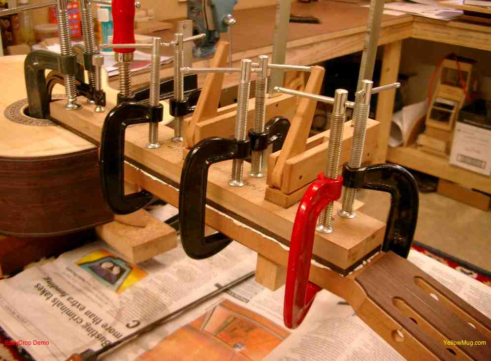

4) Apply your favorite glue (I use epoxy) and insert the smooth ends of 1/16" bits (or smooth pins) through the holes and into the neck surface.
5) Clamp it up and have a beer! Remove the pins after the glue sets up...about 30 minutes with the epoxy I use.
6) Allow to set for 24 hours, unclamp and install the 2 frets

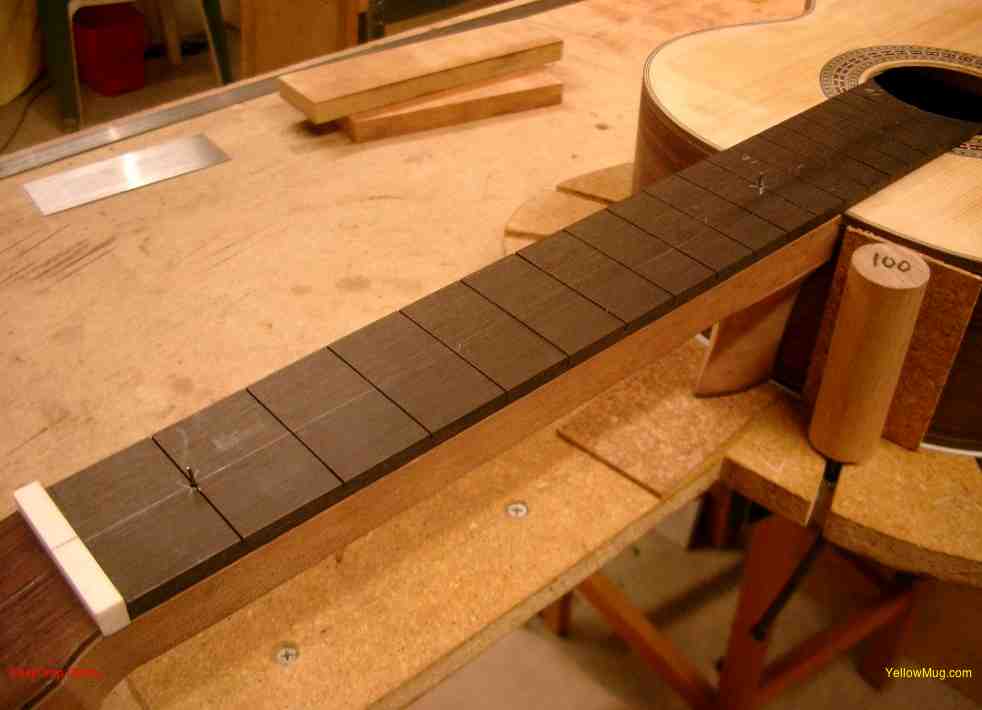

   I use two pins to locate and stabilize the board for gluing. They are
3/16" roll pins and are located between the nut and 1st fret on the treble
side of the board about 1/8" outside of the truss rod slot and the other
falls between the 12th and 13th frets on the bass side the same distance
off of the slot.
   The pins are short enough to be securely set into a 1/8" deep hole in
the fingerboard and a 3/16" deep hole in the neck. This provides great
solid stability without a risk of beng able to break through into the holes
while shaping the neck.

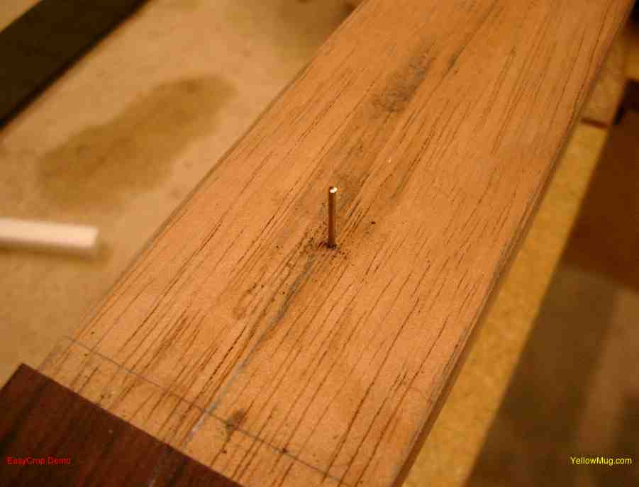

I do it slightly different. I have a template that matches my fretboard and
neck taper that has 2 holes drilled through it, one in the 1st fret area and
one down around the 12th I do believe.
I align the template on either piece, order doesn't matter, and with the drill
press drill the 2 holes into the neck and backside of the fretboard (very
shallow-about a 1/16th on each). I then take a cross-section of hot dog
roasting stick about 1/8" tall and glue into the holes I drilled into the neck.
Apply glue, then align and place the fretboard's corresponding holes onto
the stub of the protruding stick and clamp.

Something I learned from Mark Swanson several years ago, shoot a couple of staple from a staple gun to the underside of the fb. The wood is so hard that the staple barely sets into the wood. Nip off the ends to just leave a little nib of the staple, align the board and press down into the mahogany. Now you can take off the board, apply the glue and reset into the holes and your good to clamp. Staples stay in the neck, sort of the same as Kevin's and Chris'
