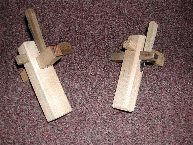

Since your a hand tool kind of guy, you can make a few of these binding cutters. Mr. O'brien made these for me. 2 shots taken of front and back.
Good luck!

PS I googled both gammil and Gramil and couldn't get an Idea of what they were. Any idea where I should look? (Told you I was new)

The pictures Tracy posted are gramils. There are metal ones available from LMI one of our forum sponsors. I have this one. That and a good set of chisels, and you golden.

Hey Tracy do those use a Japanese marking knife as the blade?

[QUOTE=RCoates] Hey Tracy do those use a Japanese marking knife as the blade?[/QUOTE]
Actually, it is a japanese blade that was 6" long but cut in half and ground to the right shape.

Can anyone point me to a "how to" on building a gramil? I think I understand it from the pictures, but without seeing one in action, I'm a little unclear on the details. In the one Robbie built, is it simply wedges that keep everything together?
Does the wood piece parallel to the blade ride along the top/back, then also along the side to cut the square ledge? If this is the case, does the wood piece have to be compensated to run along the radiused surfaces?

I can't post a picture, but my marking gauge is pretty simple in principle. There's a handle, with a square post straight out on the same line. The marking knife is set in the end of the post, at a right angle. There's a round rider on the post, with a setscrew. You just move the rider back to the right distance from the knife, lock it down, and mark away. I have a screw and spring setup to make fine adjustments easy, but that's a luxury. I use it for both marks; run the rider on the side to mark the top and back, then change the setting and run the rider on the top or back to mark the sides. Make all the marks before making any of the cuts.
The usual gramil has the marking knife and guide post in line with the handle. This allows you to put more pressure on the cut for stock removal, but also tends to hide the cut under your fist. The right angle gauge is a marker only; I don't use it to remove stock. That's done with chisels, small planes, and safe-edge files.
