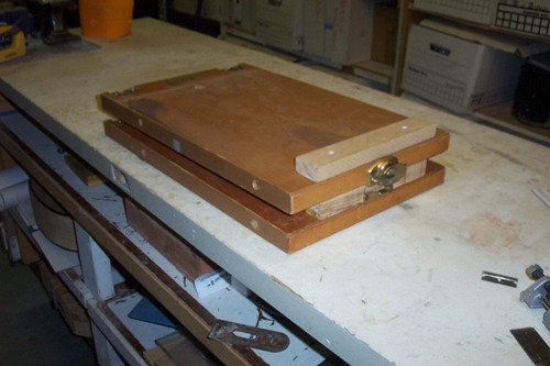

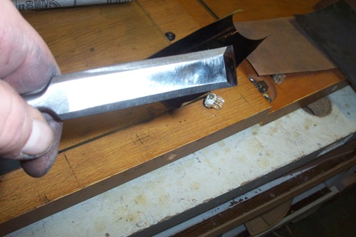

Hi folks, after watching a video that was posted by my good pal Rod True, i decided to give that a try and the results were quite amazing for my very first try at sharpening chisels, better late than never they say huh?

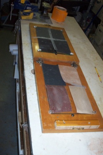

I purchased 2 glass plates from Lee Valley and inserted them in a foldable jig of sort then i proceeded with different grits, dry on the first lower grits and with water on the higher ones, polished them to a mirror sheen at the end, i still need a bit of practice but with good elbow grease and good will, i think i'll have them all sharpened very soon, thanks Rod!
Her's the jig
Here's the result!

PostPosted: Sun Jan 07, 2007 4:33 pm
Posts: 2997
Hey Serge,
That looks like a great set up to hold the glass.
Great idea!

Thanks Jim, i used mirror hooks?clamps? plastic thingies anyways, they help keep the sandpaper down in the corners and the plates down on the surface.

I must say thought that that chisle sure looks good Bro. Rod True39090.0581944444

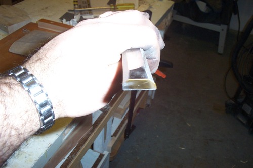

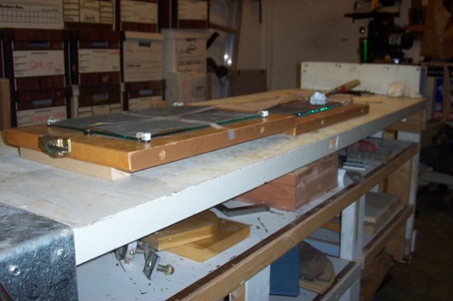

PostPosted: Sun Jan 07, 2007 10:19 pm
Posts: 1055
Hey Serge, thats a lovely hairy arm in photo No 4.
Just perfect for testing chisels on! kiwigeo39090.2644212963
