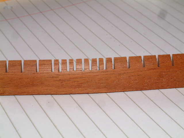

I'm not sure quite what the problem you have is. If you mean that the waist is a tight curve so that the kerfs close together at the side's waist and still leave a gap between the side and the lining, then cutting a few extra kerfs in the lining in between the existing ones in the waist area lets the linings bend to a tighter curve and contact the side. Like this (done very crudely and quickly to illustrate):

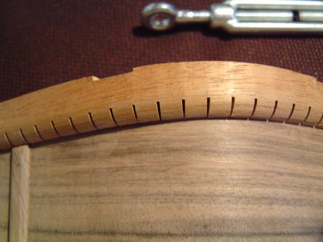

I've never found it to be a problem. I always slightly wet the reverse kerf linings on the outside to make them more flexible and less likely to crack when I'm installing them. There seems to be enough flexure to allow for the 15' dome
There is enough elasticity in the damp wood to go round the dome, the kerf closes up slightly at the bottom to allow for the dome as you can see.

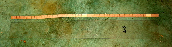

I just made some linings last night, so I will show my take on this. I like to profile the linings to match the curve, or dome, of the sides. When they wrap around the sides, they follow the countour and there is no twisting.
I use a flat template of the domed sides to draw two parallel lines on the lining stock. I cut the bottom of the lining first, then plane it to the line and clean it up, and let the other edge stay proud a little for trimming after they have been glued. Then I kerf the linings individually with a band saw by setting up a stop block behind the blade to control depth of cut.
The photo shows the finished piece.
