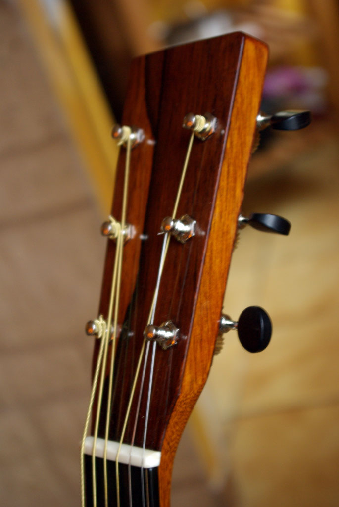

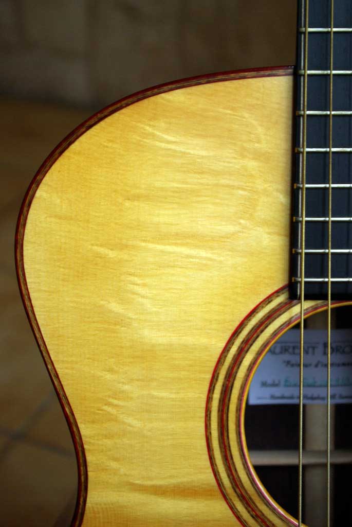

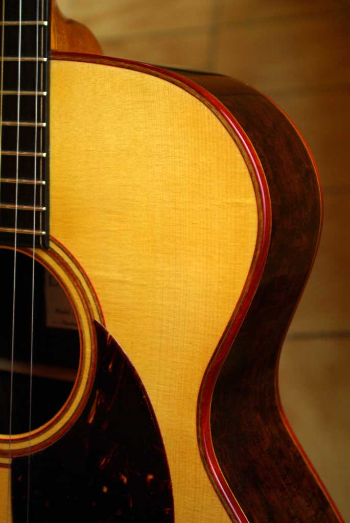

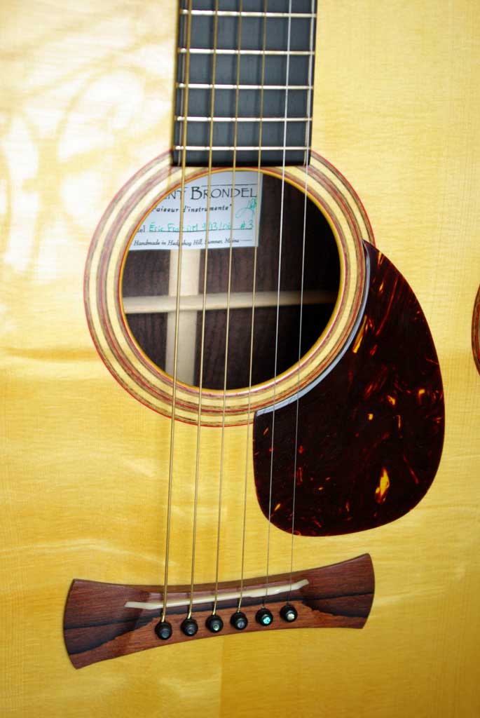

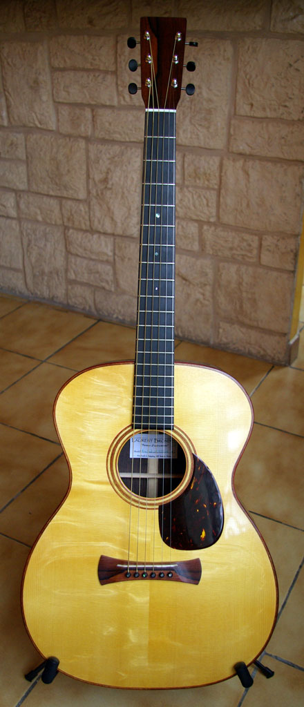

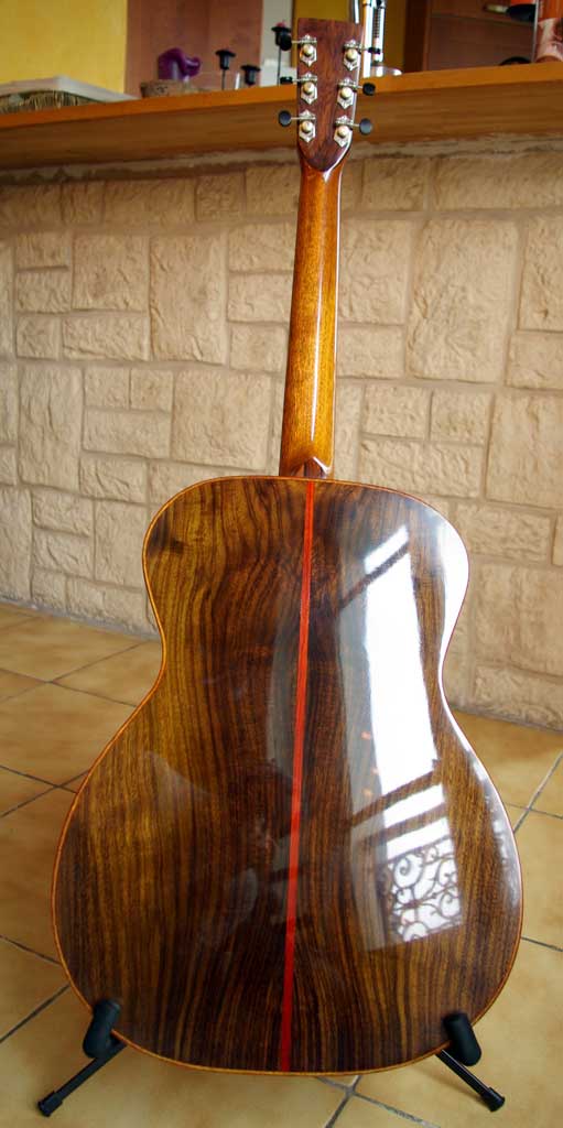

Hello folks, it's been a while since I've posted but last year has been
extremely busy with setting up a new shop and building 8 guitars. I also
started to work as part of Dana Bourgeois crew at Pantheon guitars here
in Lewiston, ME. Here are some pics of an OM I completed last October,
specs are German bearclaw spruce top, Indian rosewood back & sides, red
spruce bracing, mahogany neck, ebony fb, Madagascar RW bridge,
headplate and heel cap, bloodwood, flamed koa and maple trim, 25.7"
scale length, 1 3/4 nut width, 2 3/8 bridge string spacing, hand-applied
oil varnish.
Laurent Brondel
West Paris, Maine - USA

Thanks all for the kind comments, you guys are too nice around here…
The bridge design is somewhat inspired by Stefan Sobell, also I thought
the larger wings would provide more support and contact with the x-
braces beneath. The bracing and top, although stiff, are very, very light…
Hersh the binding is "normal" thickness, meaning probably around .060".
The purfling is bloodwood line/koa/maple/koa/bloodwood binding.
