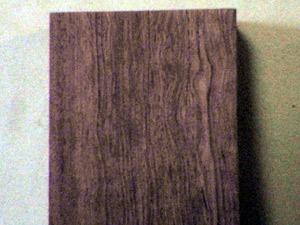

Here is a photo of the stock I am going to resaw into my sides.
My Fox style bender only has two 200W bulbs. The grain is fairly straight without much figure. I too like a subdued design without a lot of fancy appointments. I probably will sand this to 0.75 or 0.80. Should I presoak this for a while first. I did on my maple sides and had some minor ripple.

PostPosted: Tue Feb 22, 2005 4:39 am
I am not a bubinga expert but my experience with hi-figured, curly and quilted woods is that you need to bend hotter slower and longer while being careful not to scorch or force the bend. I don't pre-soak anything. I spritz figured woods a bit more than straight grain but I don't soak to avoid extreme grain raising. Darker woods I rap in foil before bending on the fox bender lighter woods that may green up I do not rap in foil.
PostPosted: Tue Feb 22, 2005 1:02 pm
MichaelP's advice sounds very good to me. I wouldn't advise soaking any wood. Sounds very counter-productive after we spend months even years stickering and drying wood. It will also cause the wood to pucker in areas. As for grain raising do it before you bend the wood. Spritz and let dry then sand. Do this a couple of times prior to bending and grain raising will be kept to a minimum when you bend. Bubinga shouldn't be much of a problem as some of the softer woods are. Spritz lightly wrap in foil or between layers of parchment, bend hot and slow. When you start to get over much 300 degress scorching could occur.
