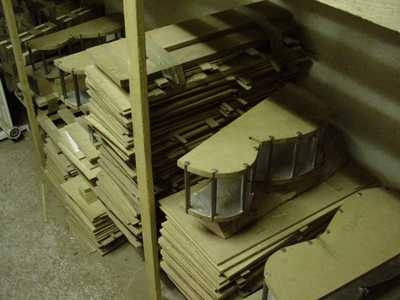

Thanks I'll look at Sunrise. Yes Carpathian spruce is European , but not necessarily European Spruce. European Spruce, be it Swiss, Italian, German whatever is of course Picea abies (excelsa), true Carpathian (or Caucasian) spruce is a different species, Picea orientalis or Eastern spruce. If some suppliers are selling Picea abies grown in the Carpathian/Caucasus as Carpathian Spruce then although not wrong they not being strictly accurate. Or more likely the European woodmills are not being completely accurate. The Carpathian/Caucasus spruce that I have is pre-war (as is all my top wood) and is Picea orientalis.
My store of top wood, my wife wonders why I have so much when I only build 4 or so guitars a year. I ask the same about her shoes!
