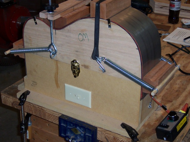

Well, I broke down and bought a blanket from John at Blues Creek, and tried it out yesterday and today. I bent some VERY curly white oak (from BobC) to an OM shape (first time for anything other than a dread). On the first side I had a little bit of cracking in the high figure, but it will be OK. On the second side, I took off another .001 or so, spritzed it twice, made sure it was hot enough, and it bent very well. Still in the bender, but I didn't hear anything snap. .   So you guys are certainly right that it is easier and much faster than light bulbs. Just don't forget the gloves.
Thanks a lot, John, I'll be back.
Ron (an OLD and WISER man)

Sam, John Hall in the US sells them along with a 220V (I'm pretty sure he has them in 220V anyway) for about 165 including a control switch.
Check out his site here.
This pays for itself the very first time you wreck a nice set of sides (learn from my mistakes) and have to replace them.
Of course using a blanket is not fool proof but it sure gives consistent heat to the wood unlike bulbs.

i'm with you on the miracles of the blanket. not only did i get the blanket from john, i also got a lot of free advice. amazing service!!
i did snap one set while learning, but a bit more free advice from john and i've now succesfully bent sapele and wenge. both beautiful woods that are known to cause some bending trouble.
i'm sold on the blanket and john hall.
by the way ron, even though 95% of the blanket bending pictures we see have the blanket between the slats, i went with john's advice and left the blanket as the last layer of the sandwich. worked like a charm as did his idea of bending the lower, then upper bout, and finally the waist. again, that's not how most of the advice out there goes, but it worked beautifully.
phil

ours is set same as Hesh with exception we use bakers parchment and not foil. Since most are archtop, use maple and almost never any discoloration or burn.

darn no edit button, but add to last we only use the two cauls and the center caul for bends.
PostPosted: Thu Apr 05, 2007 12:21 pm
I also use John's method for bending but also use a .010 slat over the blanket. I don't think it makes any difference in bending but do it for 2 reasons.
1. It prevents the spring loaded cauls from abrading the blanket and eventually wearing thru to the wires
2.The cauls slide much easier over the steel slat.
Of course I good be all wet too.

I just did slat-wood-blanket-slat. What's wrong with that, huh?????    Pervert, eh? I'll show you perversion.

BTW, not all the blankets out there are the same.
I have one from LMII which is smooth and one which came originally from John Hall (I bought it second-hand), which has raised wires.
Both work very well, but the Hall blanket definitely raises more concerns in me about abrasion and ability to slide under the cauls. I use a 'modified Doolin' method of bending- tension on the slats, waist last.
