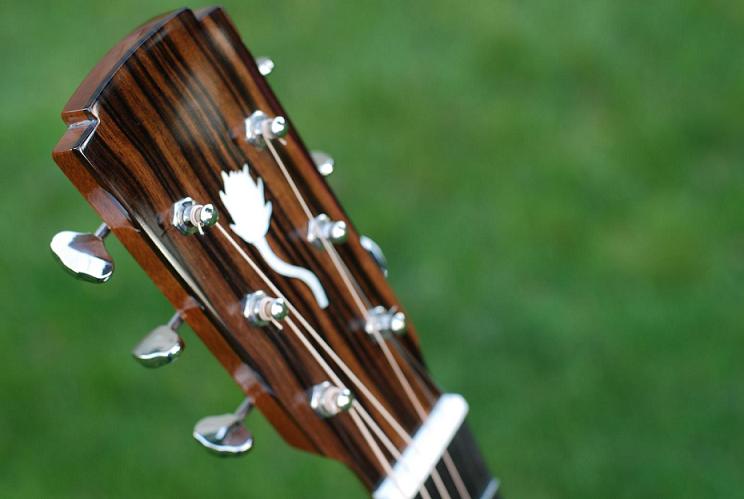

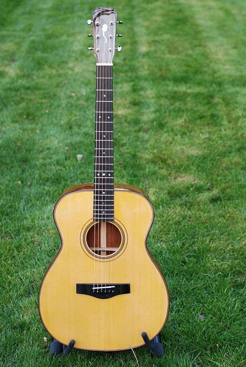

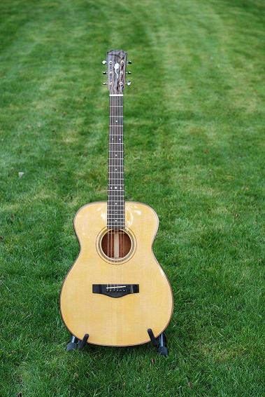

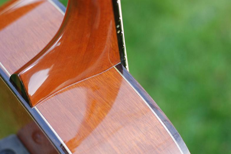

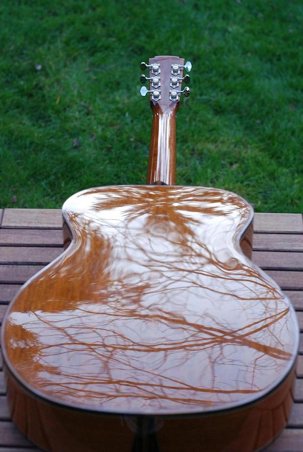

After lurking around sites like OLF for years and reading everything I could find, I fianally took the plunge.  Made lots of mistakes both in design and the work, but am happy with the results.  It sounds great. (IMHO)
Honduran mahogany back and sides
Sitka top
Macassar ebony binding and trim
Gaboon ebony fingerboard and bridge
Everything was made from scratch from lumber, but tried to keep design fairly simple on the first one.  Thanks to all that post here.  You didn't know it at the time, but were a big help in figuring it all out.

Welcome to the OLF, Doug.
You know it's not very nice to lie about the number of guitars you've built on your second post.    I swear that looks like it could be your tenth or twentieth guitar! Nice job!
PostPosted: Thu Apr 05, 2007 2:21 pm
Doug, that's a fine looking guitar, with what appears to be a very good finish.
What did you finish the instrument with?
PostPosted: Thu Apr 05, 2007 2:26 pm
Posts: 115
Thanks for the kind comments.  The finish is McFadden's nitro laquer.
PostPosted: Thu Apr 05, 2007 2:28 pm
GREAT lookin guitar!
I'm interested in how you finished the guitar also. I love the shine !
PostPosted: Thu Apr 05, 2007 2:32 pm
Nice job on your 1st Doug! What kind of tuners are those ?

PostPosted: Thu Apr 05, 2007 2:39 pm
Posts: 115
The tuners are Grovers.  I like the vintage look.
The approach to the finish was pretty much by the book nitro.  I added amber tint, again looking for a bit of vintage affect.  I wet sanded from 600 through 1500 and then machine buffed.  The whole cut and buff process took about 4 hours.

I just hate it when you pros pretend to be novice builders!
Sheesh!
This is way too good to be your first.
Very tasteful and clean throughout; I really like your headstock shape.

Very very nice, great looking macassar ebony bindings, did you also make the purflings from lumber as well?
