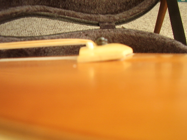

From the sounds of your discription, this same thing happened on my first guitar.
take a look
There is a noticeable ridge where the x-brace crosses under the bridge wing.

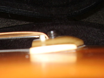

another couple of pictures for you
You can kind of see the ridge in this first picture.
This is all due, in my opinion to the top being to thin and the bracing a bit to light.
The sound on this guitar was really really nice, but alas, It's out of commission now because of the to lightly braced and thin top.

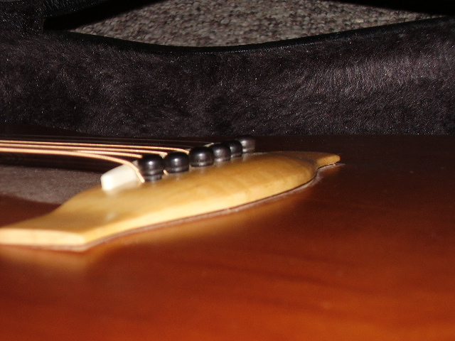

PostPosted: Mon Apr 02, 2007 9:13 am
The bridge on mine was (as you can see) really going to pull off. I think I could pull it off and glue it back down but that wouldn't help with the ridge or the extreme belly in the bridge area.
By the way, this guitar started showing these signs after about 10 months old and progressed very quickly. I put it to rest after only 2-1/2 years old.
