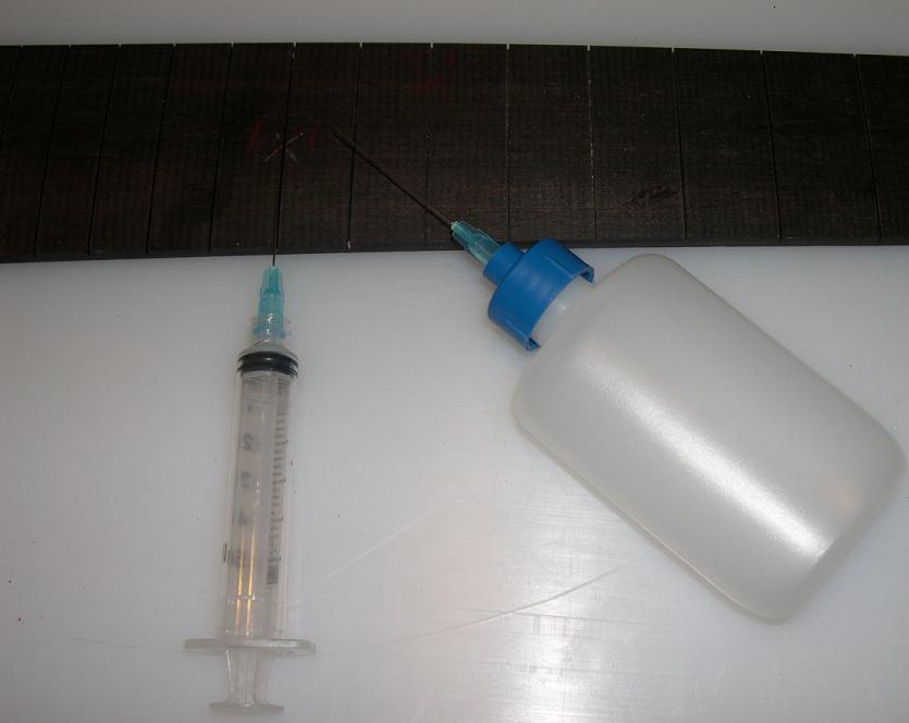

Im a top loader when it comes to glueing in frets, meaning that I use a curved tip plastic syringe to inject glue into the slot from above, before hammering the fretwire in.
However, Ive read about another way which sounds a lot faster...injecting glue from the SIDE after all the frets are already in. This would be faster because you could do them all at once.
Except it would require a real metal hypodermic needle small enough to insert in the tiny space just under the tang.
Everything available at Lee Valley or Stewmac is too big to fit in there Im guessing.
Anyone use this technique?

Though I haven't glue in frets, if you're in the Toronto area URL=http://www.theplasticstore.com/menusystem/]Warehoused Plastic Sales Inc[/URL] have the hypodermic needles with very fine metal points which would do the job. They'll ship if needed.

Here's the needle and other glue bottle they offer. The needle fits the fret slot easily and in the image is in the slot about 1-1/2 inches.

As a Doc, the 27g needle is very small. The pict above is light blue so it is
typically a 25g needle. I would think most drug stores would sell them
without the need for a prescription.

[QUOTE=azimmer1]As a Doc, the 27g needle is very small. The pict above is light blue so it is
typically a 25g needle. I would think most drug stores would sell them without the need for a prescription.
A doctor in the house...this forums got everything!
Yes I bought a 27 gauge syringe today (30 cents at the drug store) and it fits nicely. A 25 gauge would problably just barely fit.

I don't think an insulin needle will pass the glue. I have to do a bi-weekly deep muscle injection using a 20ga. needle. That is a fairly big needle. Even it is a bit stubborn with CA except for the water thin stuff. And you have to work fast. While the body of the syringe doesn't get stuck, the metal and CA like each other. In Iowa an Rx is required,mt
