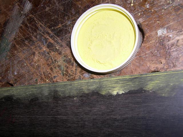

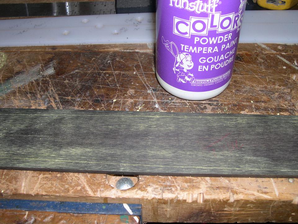

I glue the inlay on with airplane glue then trace with an Exacto knife. Once traced I remove the inlay, remove remaining glue and dust with Tempera paint power.
The power highlights the trace lines as seen in the photos below. I didn't have one with the inlay traced.
Michael Lloyd
