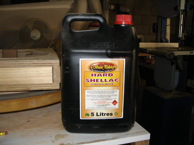

Just wanted to give an update on this product. I gave a few bottles of this to Edward Dick of EVD instruments, and he has been using it for a month now. He has used it on repairs (broken headstock) and on 2 Banjola's that he is working on. He first applied Z-poxy as the pore filler and filled the pores completely. Then he sprayed this hard shellac without thinning it at all. He used a little Preval sprayer like this. He says he is really impressed with how easy it sprays on, and how hard it gets. Compared to regular shellac, he says it sprays better, lays down easier coat after coat, gets harder faster, and sands easier than regular shellac. He says that it even french polishes easier! He is very impressed with this product, and will use it for repairs, touch-ups, and smaller instruments where he doesn't want to use lacquer. The only thing we don't know at this point is how hard it will get over time.
I'm about to start finishing my little uke with it on top of z-poxy, so I'll let you know what I find out with first hand experience. Hope some of you got in on this product, because last time I called Penn Industries they only had 20 bottles left, and that was about 3 weeks ago. Not sure if we will ever be able to get this product again.

Hesh, maybe you can try Robbie's FP method using this shellac. Just thin it the same as in the DVD, and use the same techniques. Maybe just do it on the back of your guitar first to see the results before doing the rest.
When I do my uke, I'm just going to brush it on over 2 days, 3 coats a day, for 6 total coats. I'll just let it sit for 7 days, then level it with sandpaper and then let sit for another 7 days, then buff out. If the customer wants a satin finish, I'll go ahead and do this after 7 days and be done!
Something else I forgot to mention that Edward said...he said it does not shrink back as much like regular shellac. It goes on nice, and pretty much stays that way. He will be giving me one of those banjola's, so when I get it, I'll take some pics of the finish. It is a Koa/Cedar mix by the way.
PostPosted: Thu Apr 05, 2007 1:52 pm
It's about a 4# cut neat out of the bottle, so for good FP results you'll need to thin it down some. That was my problem at first, I was wiping it off as I was putting it down, a thinner mix builds faster - go figure. Then I spied the spray gun.
I sprayed it neat, two coats, it took about a month to fully harden at about 25deg C. now a couple months later it's really hard. I didn't level until it was hardened, and went through to the wood in a couple of small places. I just FP'd those spots for an invisible repair. This stuff is pretty versatile.

[QUOTE=PaulB] ...I was wiping it off as I was putting it down, a thinner mix builds faster - go figure. Then I spied the spray gun.
I sprayed it neat, two coats, it took about a month to fully harden at about 25deg C. now a couple months later it's really hard... [/QUOTE]
Hi Paul, I stink at french polishing, but I have sprayed regular shellac with decent results. The hard shellac has to build a LOT faster than regular shellac if two coats was sufficient. With ordinary shellac I spray several thin coats, level and then let it cure for about a month before I buff, in other words treat it pretty much like lacquer. I wonder if thinner coats of the hard shellac would have made the Ubeat cure faster, like Edward Dick reported (he didn't mention how fast his shellac cured though)?
[QUOTE=LuthierSupplier] He says he is really impressed with how easy it sprays on, and how hard it gets. Compared to regular shellac, he says it sprays better, lays down easier coat after coat, gets harder faster, and sands easier than regular shellac....
... The only thing we don't know at this point is how hard it will get over time.
Tracy[/QUOTE]
It does seem to get harder than regular shellac though, doesn't it? That is why they call it "hard shellac", right? Like I said, I don't find regular shellac that hard to spray, and I also think it is pretty hard, but I wish it would build faster.

[QUOTE=Arnt] [QUOTE=PaulB] ...I was wiping it off as I was putting it down, a thinner mix builds faster - go figure. Then I spied the spray gun.
Hi Paul, I stink at french polishing, but I have sprayed regular shellac with decent results. The hard shellac has to build a LOT faster than regular shellac if two coats was sufficient. With ordinary shellac I spray several thin coats, level and then let it cure for about a month before I buff, in other words treat it pretty much like lacquer. I wonder if thinner coats of the hard shellac would have made the Ubeat cure faster, like Edward Dick reported (he didn't mention how fast his shellac cured though)?[/QUOTE]
Arnt yeah, more lighter coats would have been better as far as cure times go. My problem was that I only had 500mL of the stuff, and a brandnew spray gun that needed a proper setup for this material. I could have used my entire supply just setting up the gun - it's been a long long time since I got paid for spray painting. Next time I'll get 5L of the stuff and take my time setting up the gun properly. If I can get it right (and I'm sure I can) I think the finish straight out of the gun will be fairly impressive. This stuff just wants to shine.
