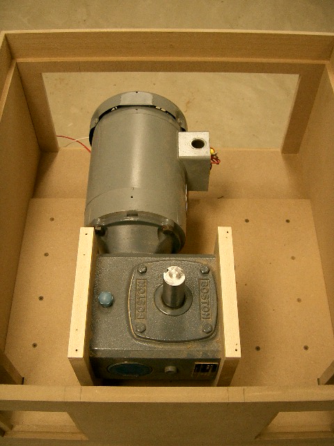

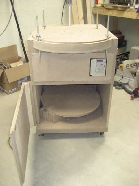

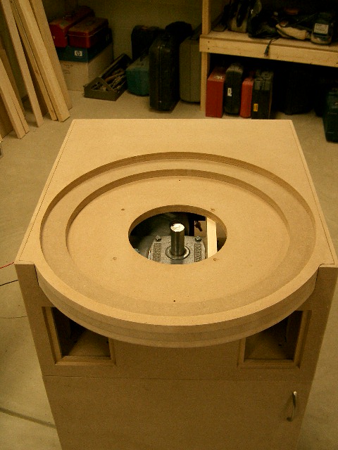

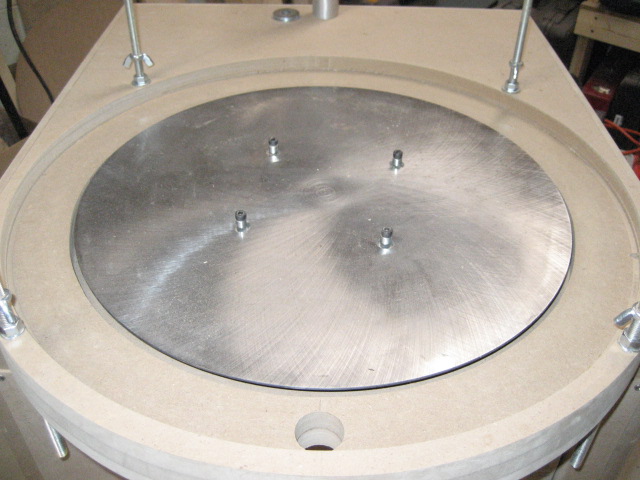

Here are a few pics the sander I made:
(Thanks John How for the idea for the threaded rods to set the sanding depth on the molds.)
3/4 HP Motor with right angle gearbox
Steel dish backing plate with drive pins.
I decided to build my dish sander with a gearbox rather than pulleys because it seemed to simplify things. I purchased the gearbox, motor, motor control, and steel backing plate on ebay and at a local industrial surplus supply. My final dish size was 22" which allows me to to store the dishes in the cabinet. I also built an attachment for routing my own dishes using the dish sander which helped justify making the setup.
Good luck and let me know if you have questions!

Thanks Gents....Brad, I love what you did, now that is a setup.... what gear ratio is the box? what RPM motor did you use? and what is the final dish RPM. I guess I would need to know if there is a shaft size / motor facing type that would be important as well to fit the gearbox. Any wild guess as to the cost of this setup?

Cost....$250. I used a 15:1 with a variable frequency drive control. THis allowed me to convert the 3 phase motor to single phase and also allows me to adjust the speed from 1 rpm to 130 rpm (aprox.) The whole project took about 3 months since I was putting it together from parts.

Thanks Brad, does this system need a 3/4 HP? did the motor and gear housing come as a unit?

[Quote=GregG]Does this system need a 3/4 HP? did the motor and gear housing come as a unit? [/QUOTE]
You will find that there are many opinions on what size motor is required. I originally had planned on a 1/2 HP and based on some feedback from various people I decided to make it 3/4 HP. My guess is that 1/4 HP is too small and 3/4 is plenty of power. (1/2 HP would probably work fine). As for the gearbox...many come with a C face mouting for a motor. As long as the motor and the gearbox have the same size mount then it is only 4 bolts and take just a few minutes. It is fairly standardized. I puchased the motor locally and the gearbox off Ebay. If you can find a single phase motor and the correct ratio gearbox then you can skip the variable speed motor control. In my case it was too hard to find everything so the speed control made it to get the right speed.
Brad
