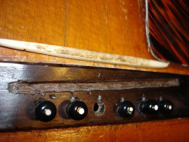

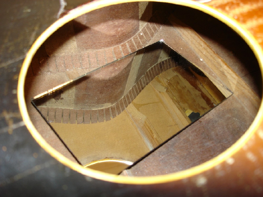

The bridgeplate -
As you can see – there is no wood between the bridge pins. I’m not sure, but I would guess that the glued paper may have been added at sometime to either help prevent the bridge plate from cracking, or to keep it from getting worse. And as I said earlier this bridgeplate goes all the way across the top – from side to side. It looks like it was made from spruce, which may explain why it looks on the thick side to me.
I don’t know how (or why) you would repair a bridgeplate in this kind of shape (both literally and figuratively speaking). I’m thinking that it needs to be replaced, and the replacement be made the size of the bridge (not the full width of the top) from better materials.
I’m thinking this would impove the sound.

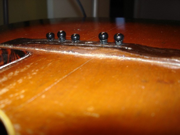

The saddle is about as wide as it is tall. Would you believe – there was lint balls and dirt underneath the saddle down in the slot. The slot in the bridge looks like it was carved out with a pocket knife – heck the bridge looks like it was carved out with a pocket knife.
As you can see, there isn’t much bridge height. And you notice the bridge pins aren’t seated all the way down.
And a close inspection of the top around bridge area suggests that this was either a replacement for the original – or the original had to be re-glued. Sloppy work.
Instead of replacing the bridge, I’m tempted to try and square up the sides and bottom of the slot for the saddle and not replace the bridge. Mainly, because I don’t want to have to deal with neck angle issues with a new taller bridge.
I need to ream the pin holes and replace the pins.
I’ve order a bone saddle blank (little larger than the slot is now) and bone pins.
I don’t mind the appearance at all. Actually, I think it adds character – she is this way because… But these are the kind of improvements I think can be made.

I'd say the bridge plate is the tricky (and necessary part of the repair. Hopefully you will get some ideas from experienced repair people about how to do that. In the meantime you might consider some conservative methods for getting that sandpaper? off the bridge plate without removing the plate.
[QUOTE=tony]
I'd strongly suggest leaving the bridge pin holes at the current size and shaving down/turning down the bridge pins if the looks are important to you. Somebody with a lathe and a few minutes to improvise could do this for you, or you could probably figure out a way to do it by hand with a simple jig. Functionally, the pins are probably doing the job as they are.
I'd also not worry about the bridge height too much at this point, though it was probably cut down to 'improve the action' (kinda a cheap alternative to a neck reset) at some time. That would explain the 'deepening' of the saddle slot, since shaving the bridge would have left the slot too shallow. This is also why the pins don't seat properly, since they are sitting in the taper at the original height- the pins are showing you where the top of the bridge once was.
Cleaning up the bridge slot (esp the bottom) and making a new saddle should improve the tone. Again, I would be careful not to make the slot any wider than necessary- it's fairly easy to sand down a saddle to the required width, as you know.

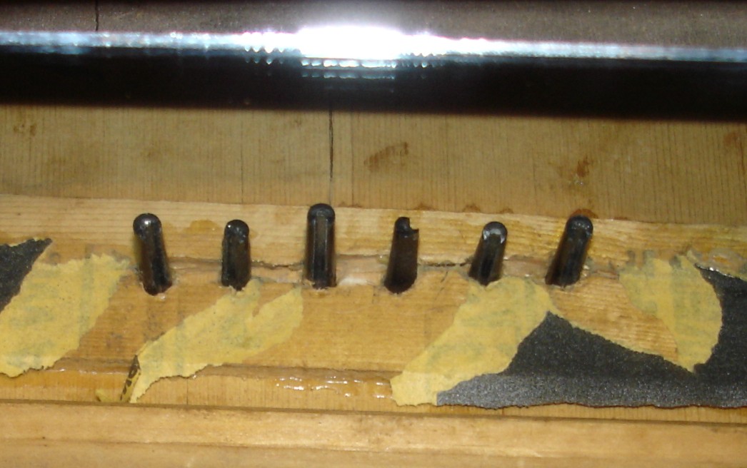

As to the bridge pins, dump those plastic slotted replacement pins that
are on it and get some unslotted ebony pins like it would have originally
had. Don't do any reaming until you have the new pins to fit. On the one I
just did I filled the missing spruce and glued a .050" maple cap just large
enough to cover the holes and support the ball ends.

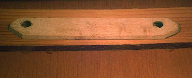

I wasn't photographing this repair, but since it came up I went to the shop
tonight to pull the clamps and take some quick shots. For the missing
spruce I simply cleaned up the edges with a razor blade and a short piece of
a file, then fit and glued in a piece of spruce to fill the gap. Really a 5-10
minute job. Then is the typical bridge plate cap - just a solid surface for the
ball end to bear on. I use thin hard maple or rosewod depending on the
original plate.
PostPosted: Wed Apr 11, 2007 5:07 pm
Posts: 2060
I hadn't drilled the inner holes yet, but I pre-drill the outer two so that I
can use two 3/16" drill bit ends to locate it as I am placing it on the plate.
Then clamp, drill, clean up with reamer, and slot for strings. Not much to
it really. The spruce patch beneath the plate does not need to be perfectly
clean, and I could even accept debate as to whether it was necessary at all
under the cap. Still it didn't take much time, and I prefer not to leave a
hollow chamber between the cap and the top.
I often use the StewMac bridge plate repair / plug tool (one of the best
tools they've come out with) for damaged plates. In a case like this
however with a full missing section, I still prefer the cap. The one pictured
above is about .050" thick, although the beveled edges make it appear a
bit thicker in the photo.

OK. Back with some maple. A friend who is a luthier gave me a slab to cut from. Question. (excuse my ignorance) What is the best grain orientation for a bridge plate?
PostPosted: Thu Apr 12, 2007 12:06 pm
Posts: 2060
When making the bridge plate itself I prefer quartered, parallel with the top
grain with X-braces, perpendicular for ladder braced. For a small bridge
plate cap however quartered or flat will be fine. It's function will not be for
any top support or transmission of vibrations through the top, but simply as
a hard stable surface to support the ball ends. Harder the better.
And for the record, the number on the block is a factory order number
rather than a serial number. The mid-late 30's numbers are not well
documented, so it's not very useful for dating. From the burst I would say
that is likely a '38, possibly a '39. Out of personal curiosity, do you have any
photos of the (kerfed or unkerfed) lining?

For strength - does flat sawn and the grain direction set on a slight diagonal from the plate make sense? Seems quarter sawn run parallel or perpendicular to the grain direction of the plate would have a better chance of splitting. But I humbly defer to those who know...
Thanks for the response.

I will try to post pic's of the kerfing later tonight - or at least let you know what was used.
Thanks again David.

Top and bottom shown.
Of interest. Cloth used to reinforce the sides and under the kerfing. Top and bottom braces and bridge plate are tucked under the kerfing, but have been narrowed next to nothing before they enter.
Hope this satisfied your curiousity. If not let me know what else you would be intereseted in...
