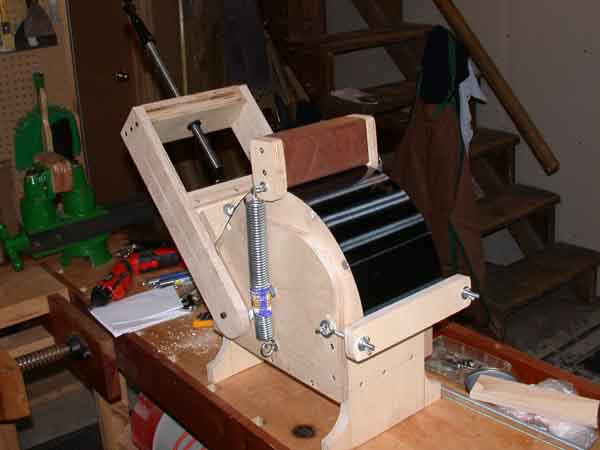

I continue to get, what I consider to be excessive springback when I bend my sides in a bender. I use a Fox style bender with a heat blanket oriented steel slat - heat blanket - side (wiped with a slightly damp cloth wrapped in aluminium foil) - steel slat.
I keep the temperature of the heat blanket around 300 degrees F. measured with a surface thermometer. I have tried as high as 400 to 450 degrees F and as low as 250 degrees F, all with the same result. I heat the sides for 15 minutes and after it has cooled completely I reheat again for another 15 minutes. Then I let the side sit in the bender overnight. Pictures to follow.

OK here we go again,
picture of the bender

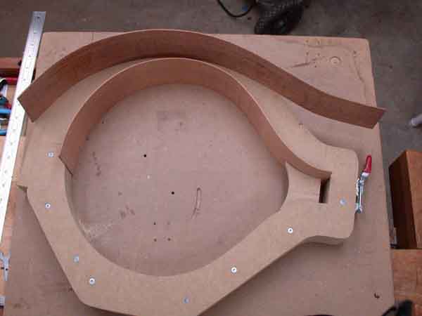

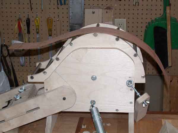

bent side compared to bender

bent side compared to mold and other side finished with a bending iron

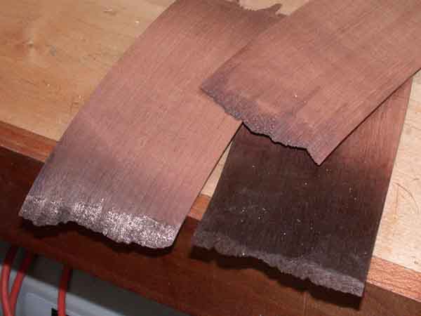

550 degrees F is just a little too hot. Ah well, ***** happens.

This also helps (a bit) to prevent burning as well. Your pic of the broken sides look like a classic 'too dry to bend' example. You can only get away with less water if you have a very resinous wood like EI Rosewood, in my limited experience-even then, water helps.

regarding the scortched side. It was in the bender at max temp for more than 12 minutes.
