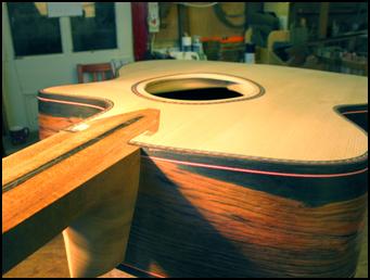

Finally, can anyone tell me what the joint is in the photo below?  I assume it is some version of a spanish heal but am not sure.

That photo is of the work of Stefan Sobell (his Martin Simpson D guitar) and if you delve around his website further he describes it as a form of Spanish heel joint. Drop him an e-mail if you want to know more - he's a very friendly guy.
I do bolt-on adjustable necks by the way.
