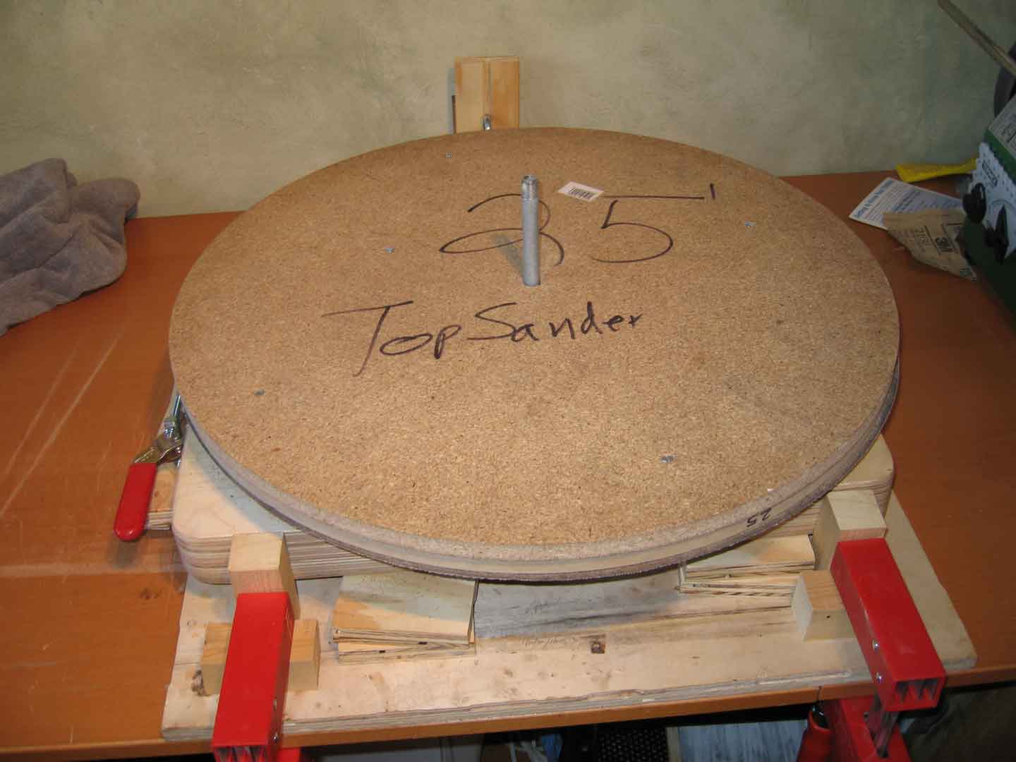

I spin mine manually over a center pole that goes through the center of the dish. One day I will motorize it
