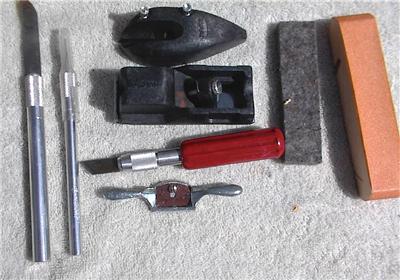

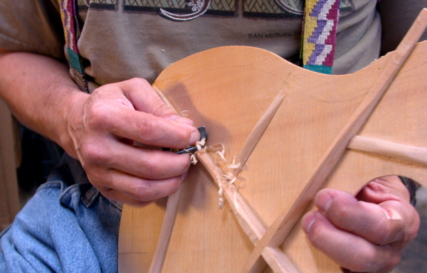

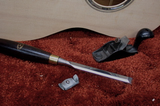

X-acto makes a tiny plane that I use for brace shaving in and out of the box. I love this thing. I got it years ago and broke off the ears to use it for scalloping braces on finished guitars. The top photo shows it intact, front and center, the middle photo modified, the bottom one shows it in action. I usually use it on the pull stroke. Very easy to control. The blade is not such high grade steel, but it holds up pretty well since I hardly use it except on braces.

edit:
spokeshave, not plane
