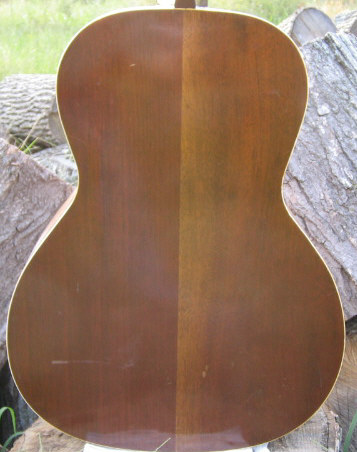

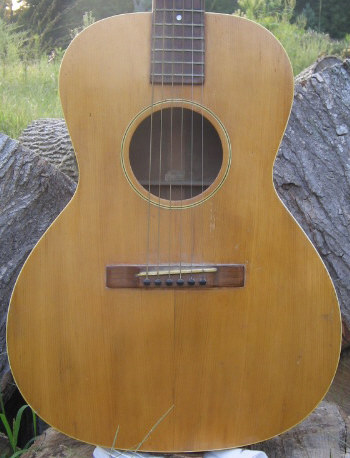

Hesh, I've got a '37 Gibson that's built very lightly. It's had a rough life (looks like it's been all the way to New Orleans) and has a couple of holes in the back, top, sides. The back and sides are a little under a 1/16" thick and, despite the damage, is still holding up fine. I based my dred guitar on this info.

Bruce, that's incredible - back and sides less than .060"!  More details please.  What species is the wood?  It's not cupped or warped?  How much does the guitar weigh?

I'll get some pics for you when I get home, but it's really nothing special. The b/s are low-grade mahogany -they don't even match. No warps or cupping - just damage from a family member's 60s college dorm life and a dozen moves across the country.

I just weighed the Gibson on my triple beam balance and it weighs 3lb 3oz. Here are a couple pics:

Bruce, thanks for the pics - is that some future back and side wood in the background?  I like the shape of the little Gibson.
