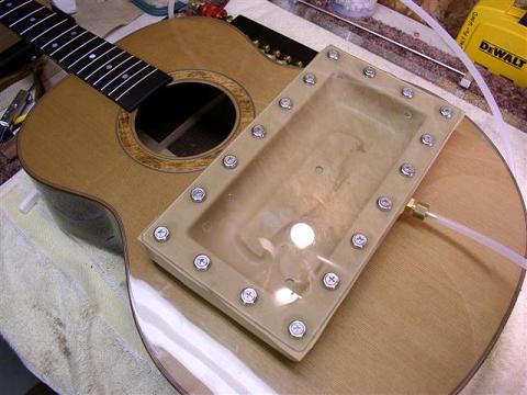

I have a vacuum setup in my basement. You don't need a compressor, just a vacuum pump, which is a LOT more quiet than a compressor. I have a setup for braces, and one for a bridge. They're easy to make and can be made such that they store away easily out of the way. The most expensive part is the pump. I wouldn't hesitate to get into using vacuuming if I had it to do all over again. If someone could provide equipment at a good price, it's a good move.

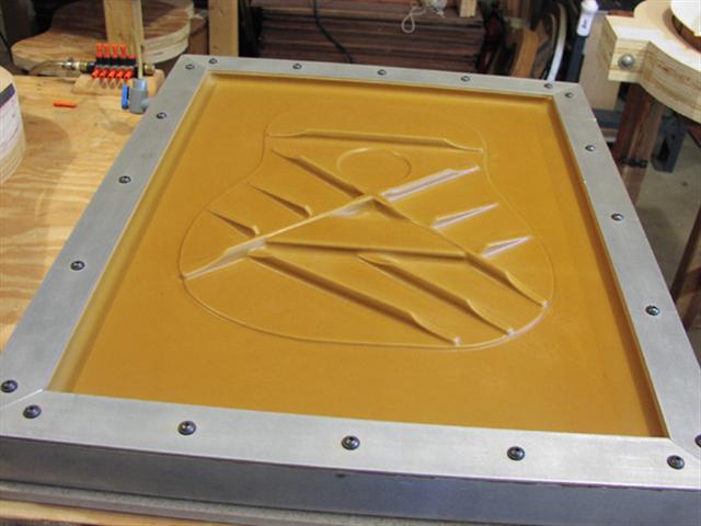

Brock, like this?

PostPosted: Tue Mar 01, 2005 2:13 am
Posts: 8556
Oops - should have mentioned, this is Michael Keller's Jig. Sorry ... Actually, the use of a press is much quicker, and easer to use HHG with. I use this press for my bridges and I always use HHG. Don Williams made this up for me and i love it. I have tried to use HHG and the FOX type clamp for my bridges, but im just not fast enough, and the glue gels, with the vac clamp, i plop the bridge on, push in the index pins, lay the press on and run it for 10 minuets, then remove it, clean up the squeeze out, and replace it for 45 more minutes.

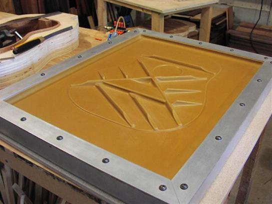

This vacuum setup is used to join double-top soundboards that use Nomex inside. Top braces are also joined:

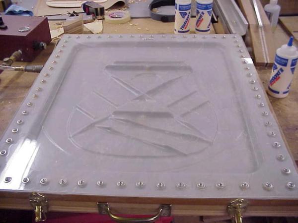

Here is a shot of my vacuum jig which I made in 1992 and demoed at the
last ASIA symposium. It has worked flawlessly for 13 years. Inside there is
a cutout that accepts my 24" round radius plates. That allows it to be
used for either the top or back of an acoustic instrument. I use a GAST
vacuum pump which I bought on eBay for under $100.00. I recently
bought a spare although it is very reliable and has been working for
about 6 years. Anyway, here is the picture:
Sylvan

PostPosted: Wed Mar 02, 2005 1:03 pm
Sylvan, I am getting ready to make a vacuum press similar to yours. Can you tell me what you are using for the membrane, and where you purchased it?
TIA,
Dave
PostPosted: Wed Mar 02, 2005 3:01 pm
Posts: 389
Dave -
Check the article at my web site, wellsguitars.com. It gives the sources for
the membrane, etc. at the end of the article!
Sylvan
